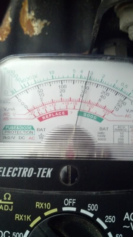

Here's a pic of my reading after the alternator swap. My meter is set to RX1K, which I understand to mean ohms times 1000. If that's right, then the reading is 3200 ohms or .0032 megaohms (compared to 1800 ohms or .0018 megaohms before).

... If that's right, then the reading is 3200 ohms or .0032 megaohms (compared to 1800 ohms or .0018 megaohms before).
Sounds right. Still lower than what I'm reading but definitely an improvement over the 1800 ohms.
I assume you measure it with the thick white B wire disconnected? this way you're only checking resistance from B terminal to ground and nothing else.
It's possible the settings on my meter aren't working properly or I'm not reading them right, but regardless the reading nearly doubled so that's a good sign. I am measuring it just as you described in the original post, the wire is disconnected from the B terminal.

Originally Posted by ARK_SWAMP_RIDER
... but regardless the reading nearly doubled so that's a good sign....
Cool, Definitely better!
