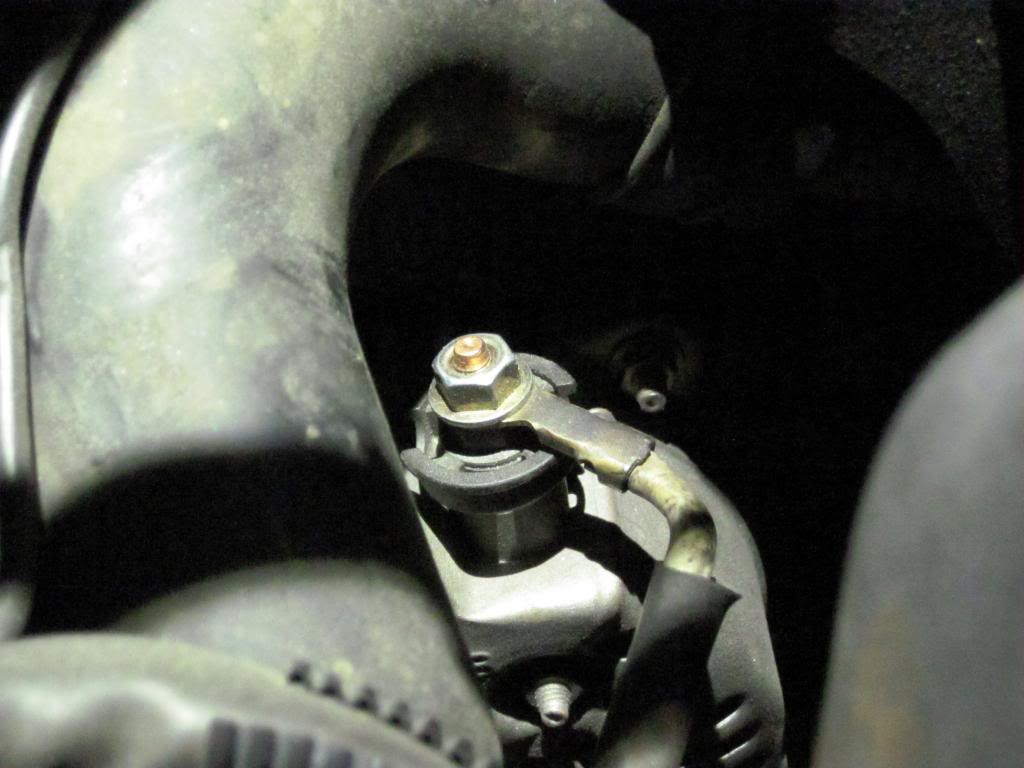

I really suspect the alternator, but please don't replace until you have identified exactly what's wrong, like Chickenman suggests. Could it be possible that some of the diodes in the alternator rectifier are shorted, or stator winding has short to ground, causing current to ground though stator winding? Try this:
Unscrew nut and disconnect thick white wire from "B" terminal of the alternator.
Measure resistance from the copper bolt to ground (i.e., ohm setting, red test probe on copper screw, black test probe on chassis ground/alternator body). You should get a very high resistance. I got 0.357 meg-ohm using my nice Fluke [0.395 meg-ohm with my HF special ] If you get significantly lower than that, you might have bad diodes or stator winding sorting to ground.

I measured just as you described and got a very low reading. My understanding is this means 1800 ohms, or .0018 meg-ohm. Does this mean the alternator is toast?
Not best pic, but maybe you can read it. Set to measure 1k ohms and a reading of 1.8. The high reading (500) is far left, and low reading (0) is far right. Name:  IMG_20130522_081318_796_zpscfde78ab.jpg

Looks like our analysis and actual measurements point to the alternator. Couple of other things-questions to other members
ARK_SWAMP_RIDER's measurement of 1800 ohms to ground means there's or are bad diodes in rectifier. However, 6.67mA of current draining through alternator rectifier/stator windings to ground does not seem enough to drain the battery overnight. Has anybody measured normal current draw on battery while car is off? Is it anywhere near 6.7 mA?
It seems that Rikoshay's statement of "battery and alternator as a couple" applies here.
ARK_SWAMP_RIDER, wanna double-check you battery? If absolutely good, get a new alternator. Consider the Jaguar 130A alternator- plug & ply except for pulley swap and minimal bending of mounting bracket.

Alternator has bad diodes. 1800 ohms from B terminal screw to ground is too low. My good, brand-new alternator see post above^^ has 400,000 ohms to ground. Therefore, it is not properly charging the battery. At the end of the day, battery is not fully charged- just barely enough to crank.
When OP leaves alternator B wire connected overnight the 6.67 mA drain (12Volts/1800 ohms) through alternator, plus other normal drain through the circuit is enough to drain battery so it can't crank.
Also possible that battery's weak.
