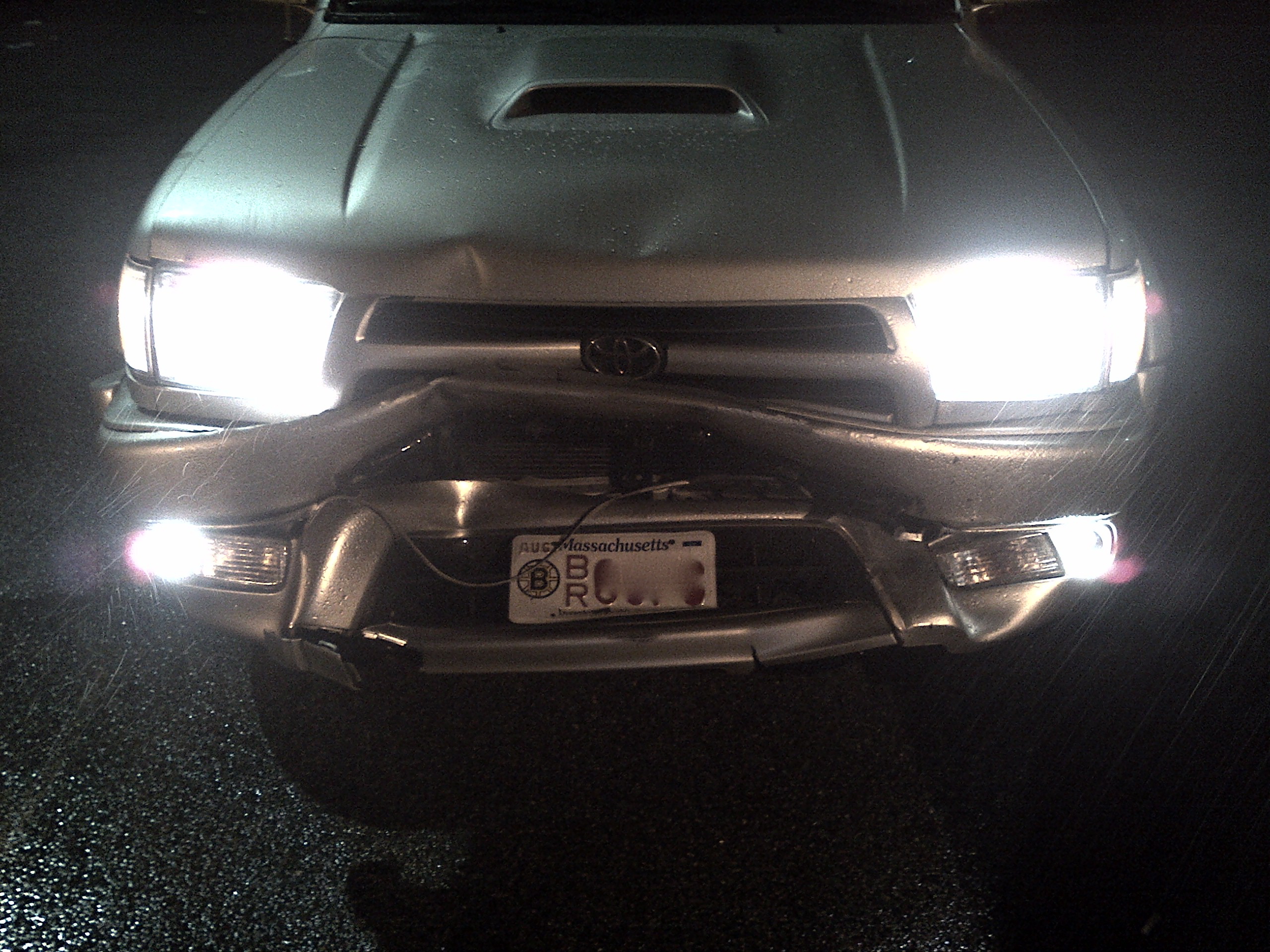

Front Bumper
Sport Hood
Grille
A/C condenser
Radiator

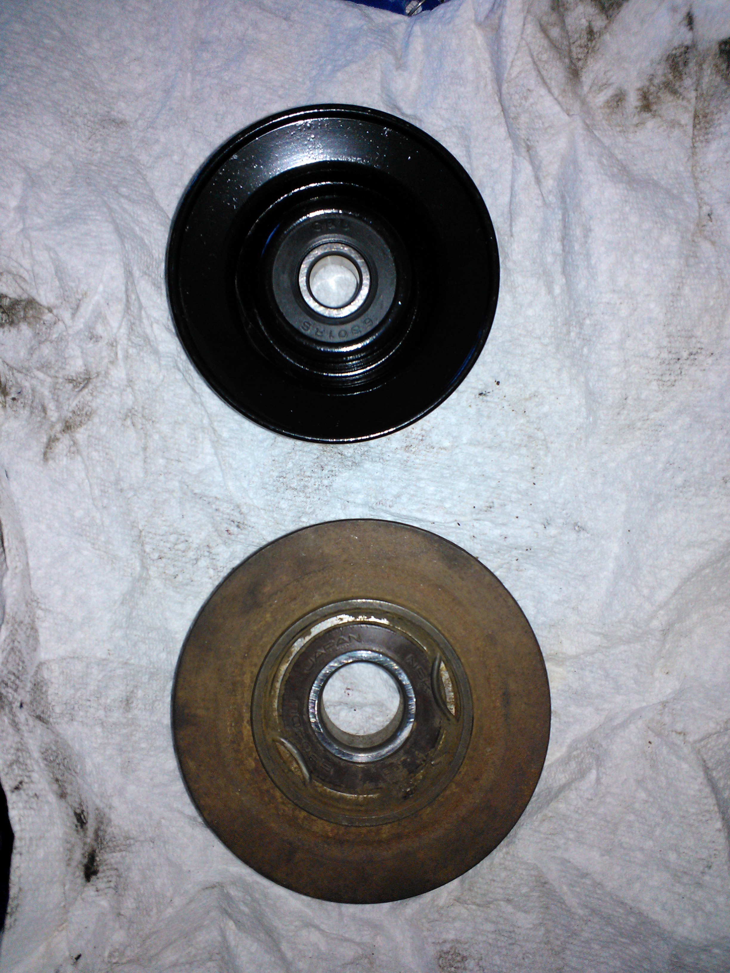

So the idler pulley on my '93 pickup failed and I can't seem to find a replacement. Here is the one I bought next to the original, they're clearly different sizes. Will the new one still work?
um... It doesn't look like it considering that the bearings look like a different size but in reality what engine is it for and what does it do? The new one looks like the idler pulley for the air con on a 3vze. The old one looks more like the idler pulley for the power steering on a 22re but I could be very wrong.
