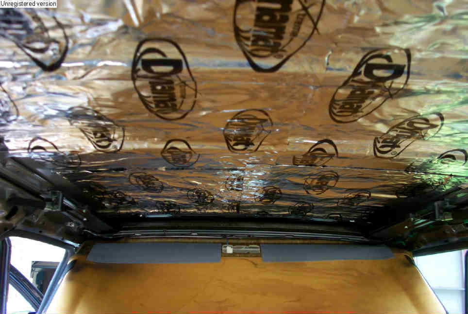

Hi all, this last weekend I was so inspired by this post that I went ahead and braved the 93 degree heat and began taking out the headliner of my 97 4runner limited. The weekend before I tried this but could not figure out how to take the rear dome light off. Well, I breezed through that portion of the removal process and was on my way thanks to this thread. I ended up breaking every one of those circular fasteners when removing that damn headliner(had to put serious muscle into it). I did not feel the need to remove the entire liner, just up to where the moon roof starts (mainly because I could not loosen the screws on the driver's side brace handle or whatever you call it). I used Dynamat Xtreme (36sq ft bulk pack: ebay $96) to cover the roof and layed it directly over the foam stuff near the back. I was quite pleased with the sound (or lack of sound) after the Dynamat was laid. The main reason for this project was that I was getting rattles from the cargo area, but the rattles did not go away... It turns out that my sub box is rattling, something is loose in there, but it is on it's way out. I have 2 new 12" Adire Brahmas going in after I install a new 200amp H O alt and Optima yellowtop. Well, here are a few photos of the project:

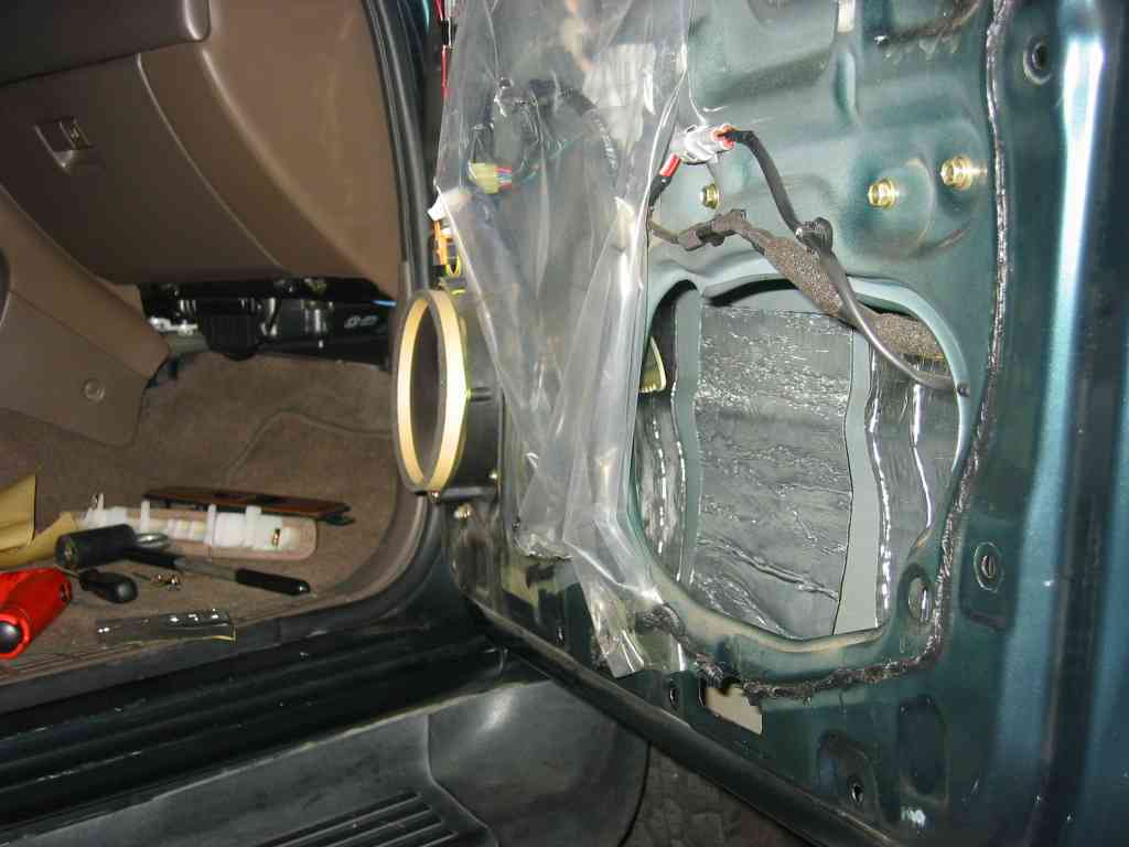

IMHO - You probably won't gain much from adding acoustic mat insulation around the sunroof on top of the headliner. The configuration of the bracing and the sunroof bracing appears to pretty much eliminate a lot of the noise harmonics above your head.
Based on my research on this and knowledge of architectural acoustics the small areas make a small difference. I attached a photo illustrating this concept used on my doors. The little gaps don't appreciably affect the performance.
The primary benefit comes from three areas:
1. door and side panels
2. roof (important in a SUV - even for heating and cooling)
3. floor boards
Just find a way to kill all that bad sound energy and world will be wonderful once again...
