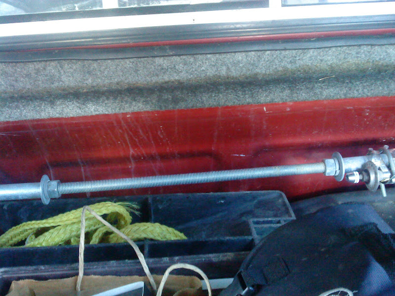

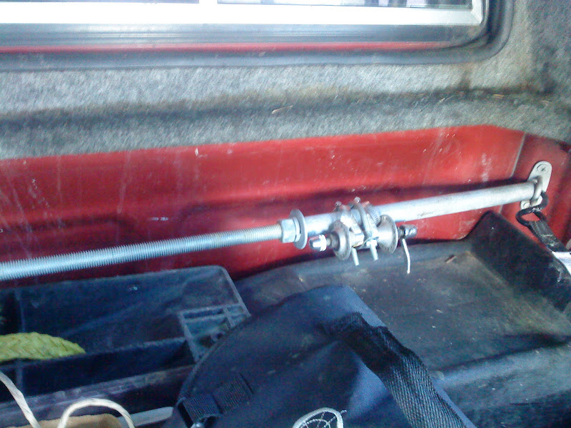

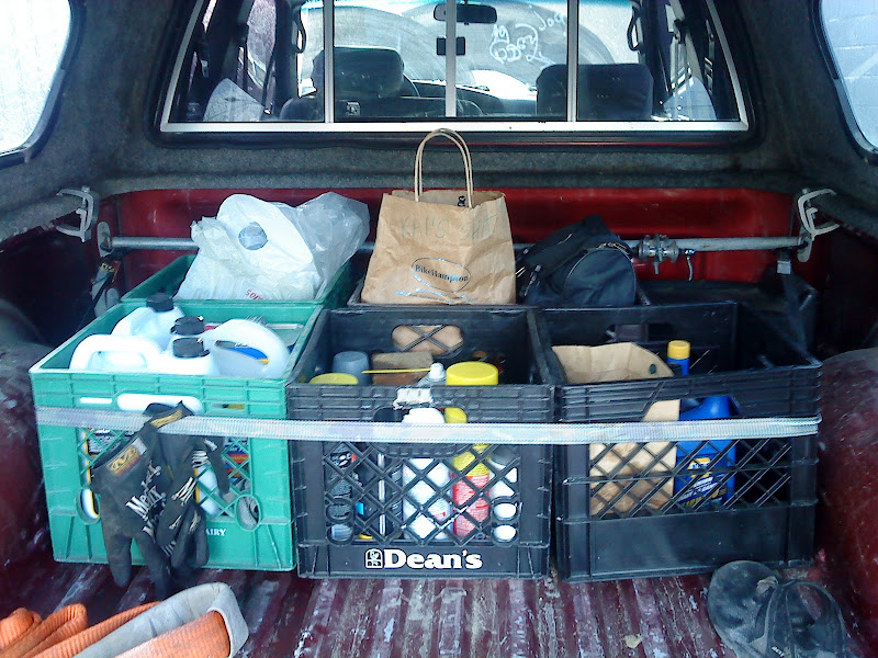

Okay finally took some photos
Heres my bed organization setup, and in the background you can see the bike rack too
How I mounted it
You can see the threaded rod bit that works sort of like a shower curtain rod that adjusts the width of the rack and keeps everything from moving around
Edit: the hubs have little notches cut out of the flanges to keep em from shifting around. The u bolts were originally what was holding the hubs to the pipe, but they just werent cutting it so they are there only as a backup retainer, the hose clamps are doing all of the work.

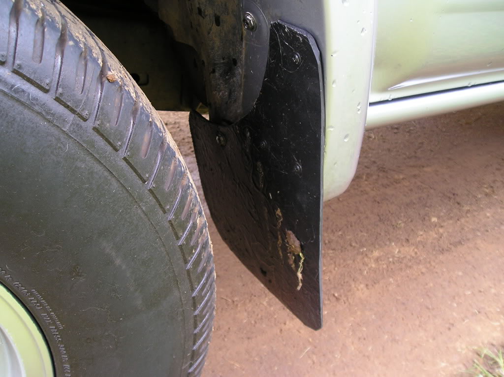

So I like the look of my runner without the running boards, but I don't like dirt and other road crap messing up my paint, so I drilled on some cheap mudflaps. (I have a Limited btw, which has no available OEM mudflaps). They are pretty good, they keep 99% of dirt and stuff off of my paint now.

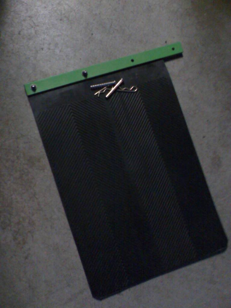

Mud Flap Mod
Here's a cheap way to add some bigger mud flaps to your rig to appease the local five-oh's and state laws.
Ingredients:
x1- set of 12"x18" mud flaps from the auto parts store
x1- 1" barstock
x4- 1/4" diameter bolts
x4- self locking nuts
x4- small washers(nut side)
x4- fender washers(bolt head size)
x4- retaining pins
x4- clevis pins
Basically attached the barstock to the mud flap with the two bolts, but drilled four holes total.

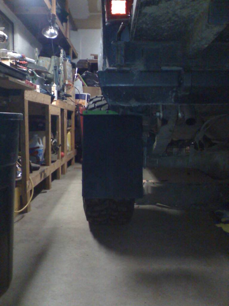

Using the stock mud flap location I simply ran a 1/4" drill bit thru the OEM mounts to run the clevis pins thru. Obviously, I've bent that factory bracket back enough to clear the tires during full stuff.
The mud flaps cover the tread pattern effectively.
They also hang down low enough to be well below the axle tube.
Honestly, I have NO idea if these are going to last, but that's why they're quick disconnects. I think I spent less than $25 on this total, I had the bolts/nuts/washers on hand already.
So, there ya go. Simple and effective.
