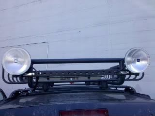

I hooked up a set of Hella 500's to the back of my roof rack that are a life saver. Backing up a trailer, backing down a dark trail, using them as spotters while camping. They are directional so I can move them where ever I need them. The lights are awesome for the price ($40 on Ebay).

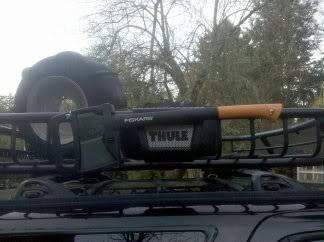

I also did a cheapo axe and shovel mount mod. $5 at Home depot, just used some conduit fasteners, cariage bolts and wing nuts.

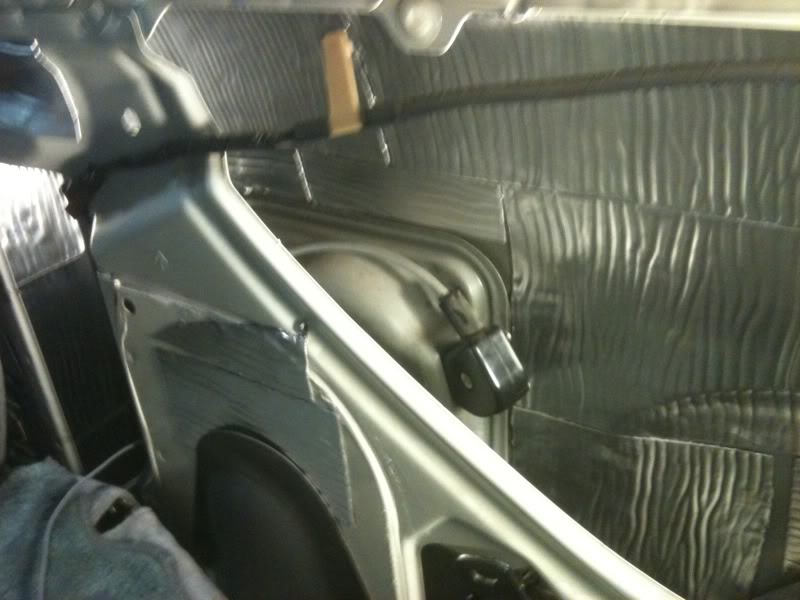

I did the same. But I used Peel and seal roofing material from Lowe's. And then I used anti fatigue matting over it. Cost less then $100 for everything.
Behind the panel around the gas filler...

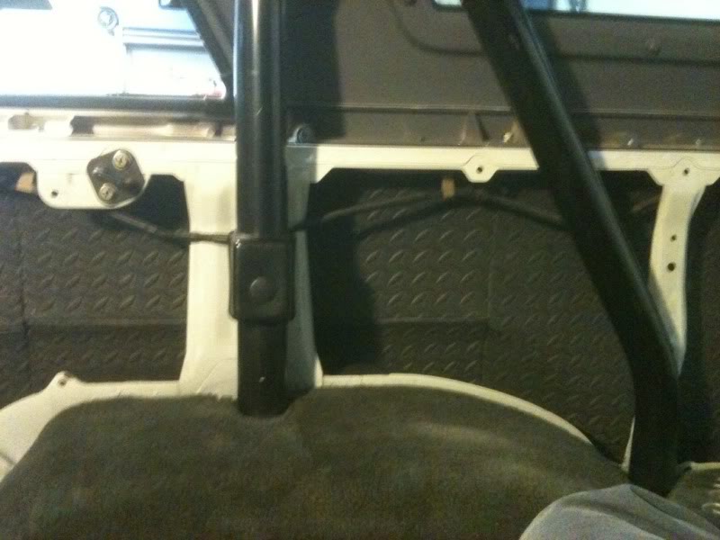

and with the foam over it.
REALLY helps with road noise. I can't believe I didn't do it earlier.
