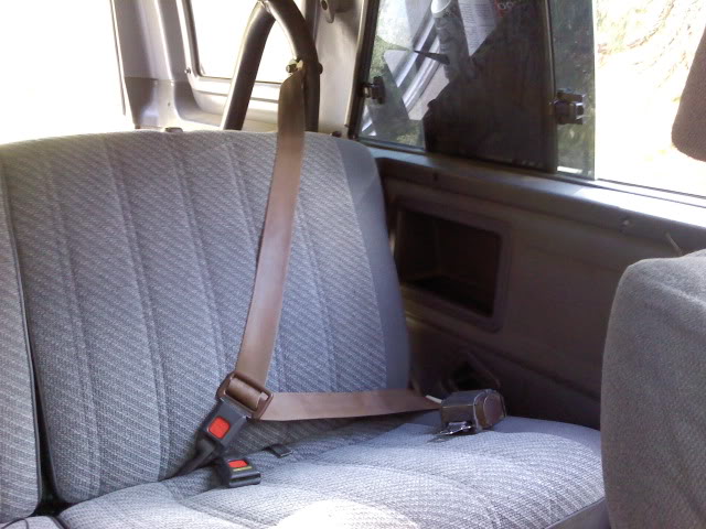

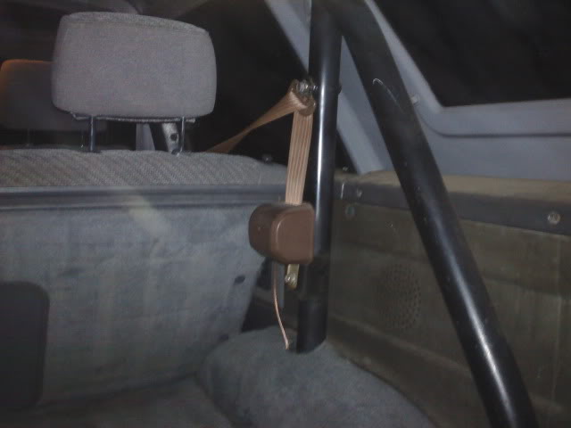

I don't remember if I've posted my mods in here already. Not about to check either. Seems like this thread is moving slow as of late, so I'm sure many will read this.
Most of my mods have been electrical. One, because I love electrical. Two, because I'm a broke high school kid.
The pix will do most of the talking, but what I need to tell you:

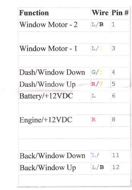

-Rear cargo window switch and driver switch are both tapped into the tailgate's wiring harness found behind the jack mounts.
-The switch for the deck light controls my KC Daylighters. (Haven't finished wiring the deck light yet.)
-I think the rear seat belts bolt right in.

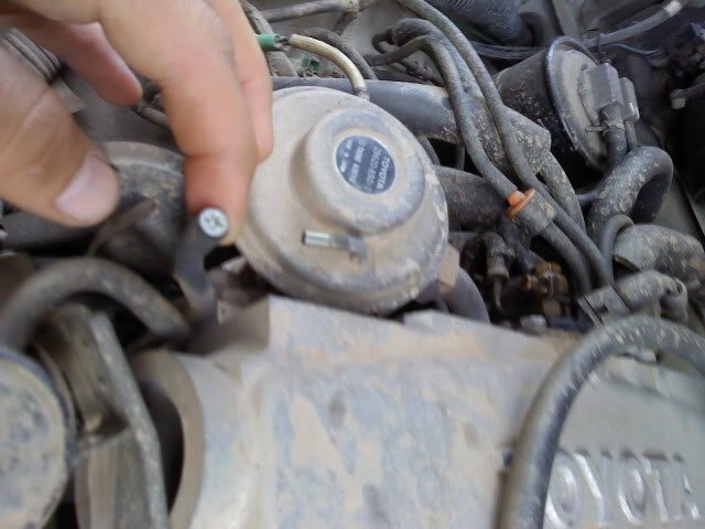

-You need a simple screw to plug the EGR vacuum.

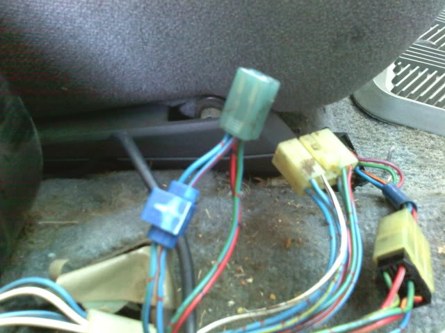

-If you ever want to remove the rear window lock button so you can add a new switch, simply splice the pic'd two wires together, otherwise the window won't operate.

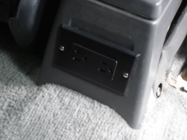

110v outlet in ashtray pocket ran from my inverter in the side P/S rear cubby: $3.29 outlet, $1.99 metal plate, bout $15.00 in wire and plugs=$20 or so..

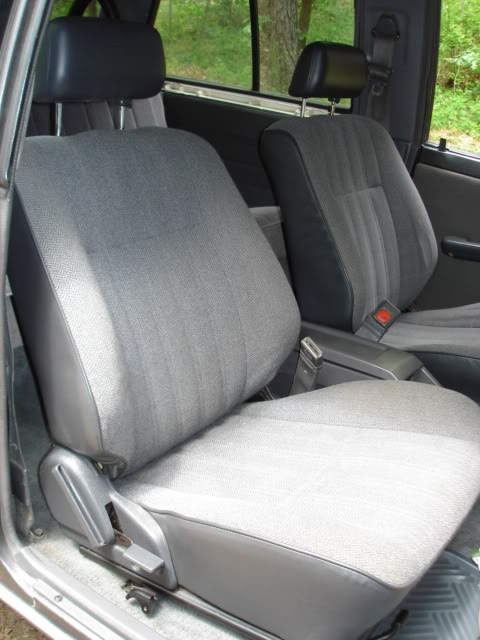

Corolla seat mod from an early 90's 4 door. Hug you alot better. Track width was perfect, mounting brackets needed to be cut and welded further apart (front to back) on the track..10ea/seat=$20....

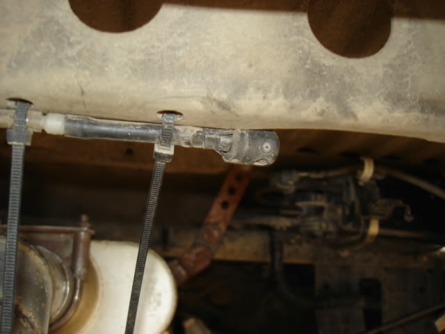

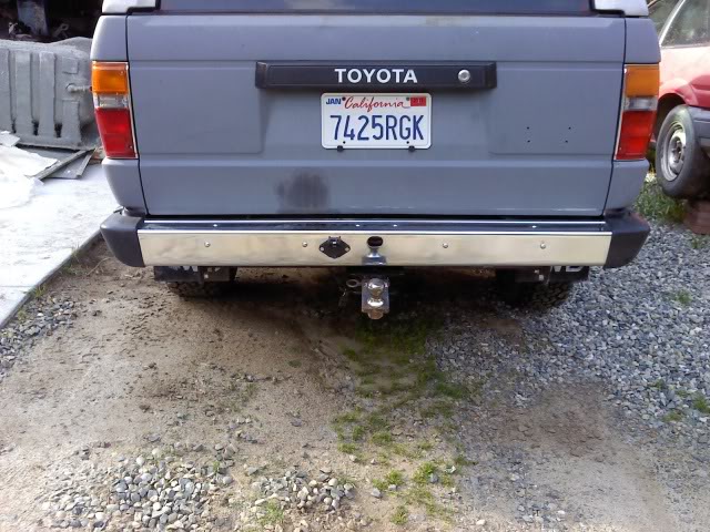

And last but not least, (my favorite) "Get off my arse" tail-gater deterent. Pulled a rear window squirter and plumbed it to my rear washer tank, and filled it with some very light oil. When somebody decides to ride in my backseat on the highway I hit the pump and "oops I'm leaking oil". I get some on my inner bumper, but way worth it. Squirter- $5=priceless...

that is awesome! i might have to steal that one from you! where did you get the squirter??

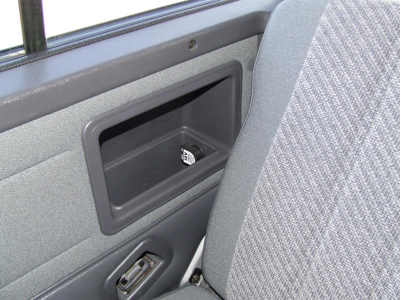

I picked up this brand new 12 volt socket at a garage sale. I installed it in the passenger side rear pocket. Wired it direct to the battery. Usable with back seat up or down.

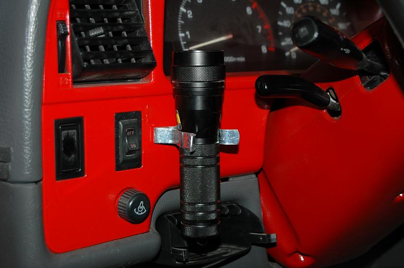

(3) using a little spring-like clip, this holds my flashlight to the dash. $0.

The squiter was harvested off a 95 4R rear window...
