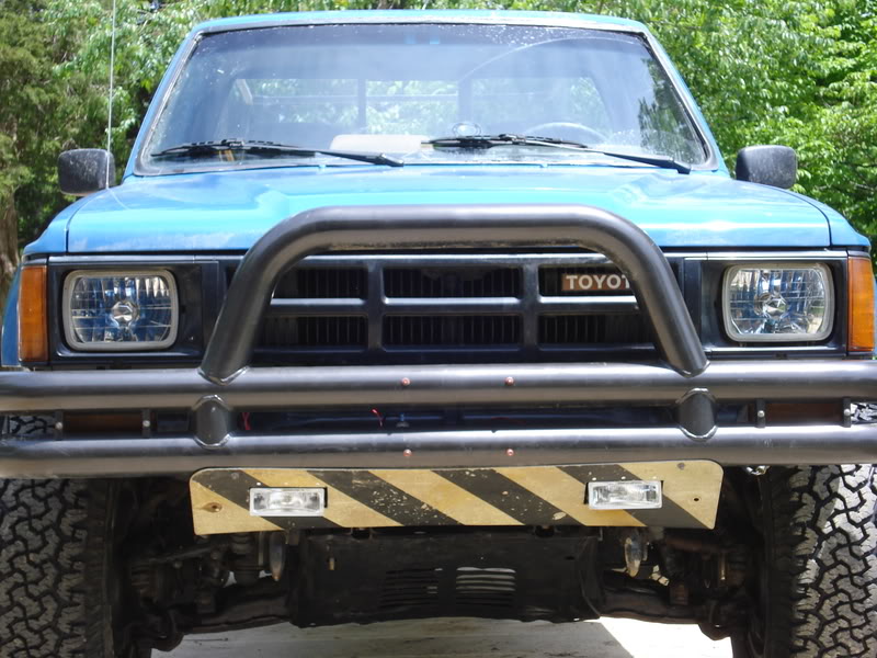

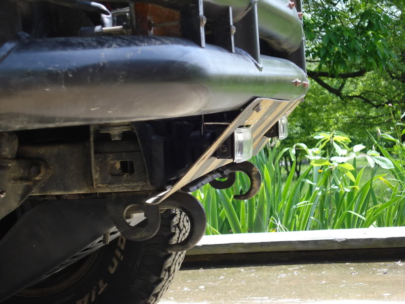

I bought a old street sign and made it into a valance skid plate this weekend and cutout two spots for some cheap driving lights
total price was 30$
I used my a/c switch for the light switch blue wire is power black gos to the lights and white is the ground so that the a/c light will light up when you turn on the lights.

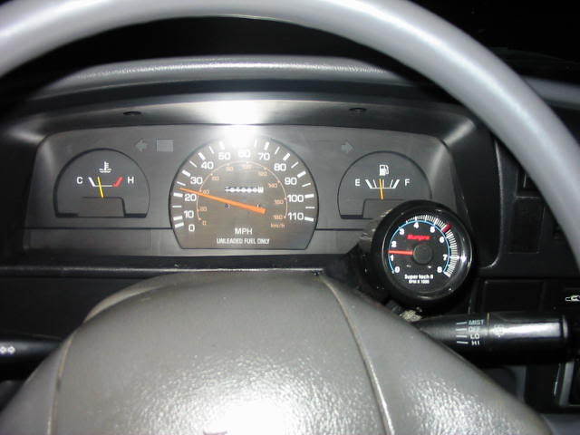

Tach...$35

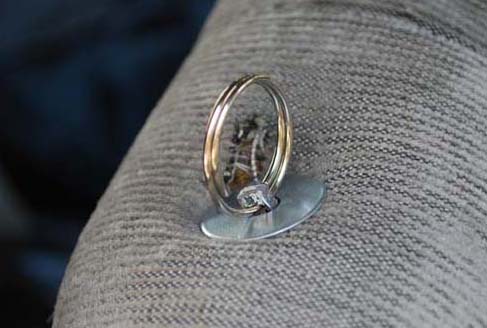

My cheap mods on my 1st gen
I've got an '87 4Runner where I solved a problem that vexed me for a while. The pulls to release the rear seat-backs, or "plungers" as Toyota calls them, were always breaking, especially while trying to get the seats to lay flat. I thought it over a bit and came up with a solution. I bought a set of old style "security" door lock pulls, cut about 1/4 inch off the top, drilled a hole near the tip, and inserted a keychain ring. Now the seats fold flat without the pulls catching on anything, and there are no plastic bits to break. The door locks cost $5 and I had the rings and washers lying around the garage. Now I can easily lay the seat flat and sleep on the trail.

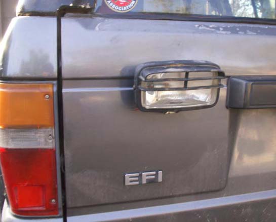

Another cheap mod I did was install a light in the rear so I can see where I'm going if I have to back out of a spot at night. I didn't want to install it on the underside of the bumper and lose clearance, or the top of the bumper and interfere with the tailgate. So logically I put it on the tailgate. I removed the tailgate cover to make sure I wouldn't interfere with the operation of the rear window and drilled a hole to mount the light. I then drilled a small hole to run the wire through. Once mounted, I ran the power for the new light through the wire harness for the rear window motor and into the cargo area, where I tied it into the power for the rear deck lamp. So not only did I not have to run a wire all the way up to the instrument panel, that light is already on a switch so I didn't have to purchase or install a new switch. I just hit the rear deck light switch and I have a nice little beam to guide my way out. And the light is hinged and can be rotated in any direction. I had everything laying around the garage so this mod cost me absolutely nothing.

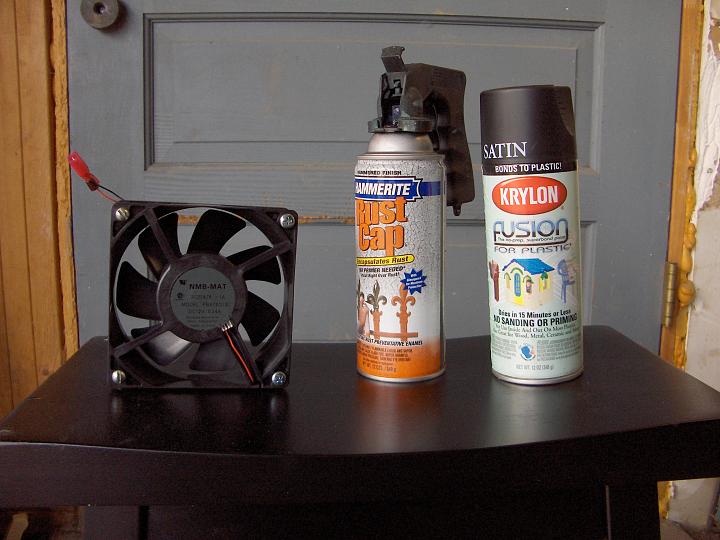

The only things I've done lately were mostly maintenance items. For those of you who want your plastic surfaces to be black again, the Krylon Fusion spray has worked well for me. Just be sure to follow the directions for surface prep. Same goes for metal surfaces and Hammertite spray (I think it's under the rust-oleum brand now).
One 'mod' I was glad to have done before summer was a couple of 12v fans. You can pick them up at any electronic supply store. Just wire them up for a cigarette lighter (or whatever power source you have) and place them where needed. Very low power draw so they can run a long time without draining your battery. I used extra long wires so they'll reach well outside the truck.

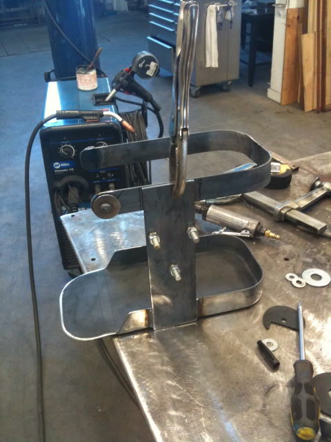

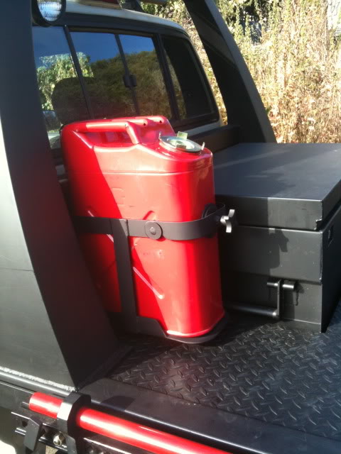

Here is a gas jerry can mod I did a few weeks ago. I started with 1" steel, 1/8" steel plate, turn knob, rubber and steel cord to lock it. The cage is mounted to the tool box with 3 3/8" bolts and is super sturdy.

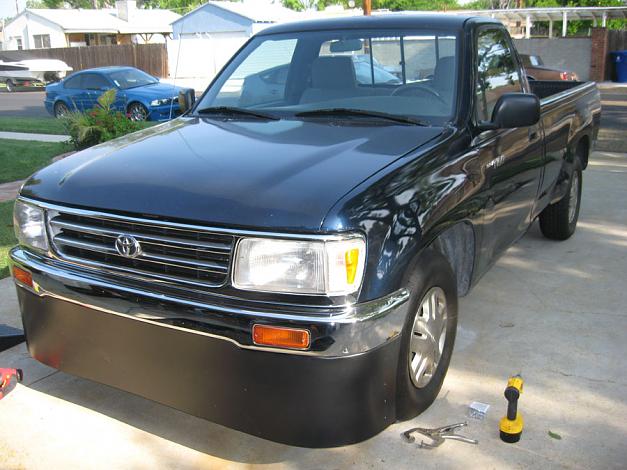

My truck is used mainly to haul stuff around and light towing so no off-road related mods but for I did put a few el-cheapo mods into it -
* Bought some $3 worth of U bolts and welded them on both sides of the bed of the truck, now I have plenty of places to tie stuff down.
* Modded the front bumper by removing the bottom skirt and replacing it with a deeper cut air dam.
Measured an improvement of 2 MPG on average and much improved stbility at highway speeds.
Total cost $35.
* Put a nice aluminum shift knob, just a classic satin finish ball. Feel much nicer in my hand!
Free mod 'cause I already had the knob
