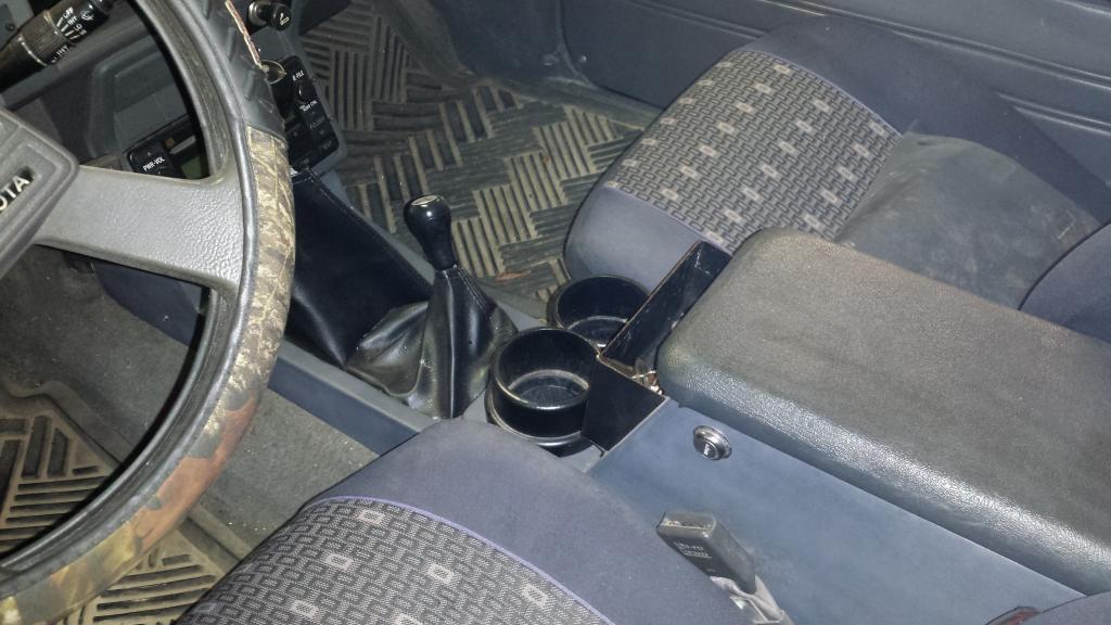

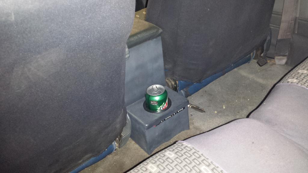

custom console with three cup holders and locking storage.

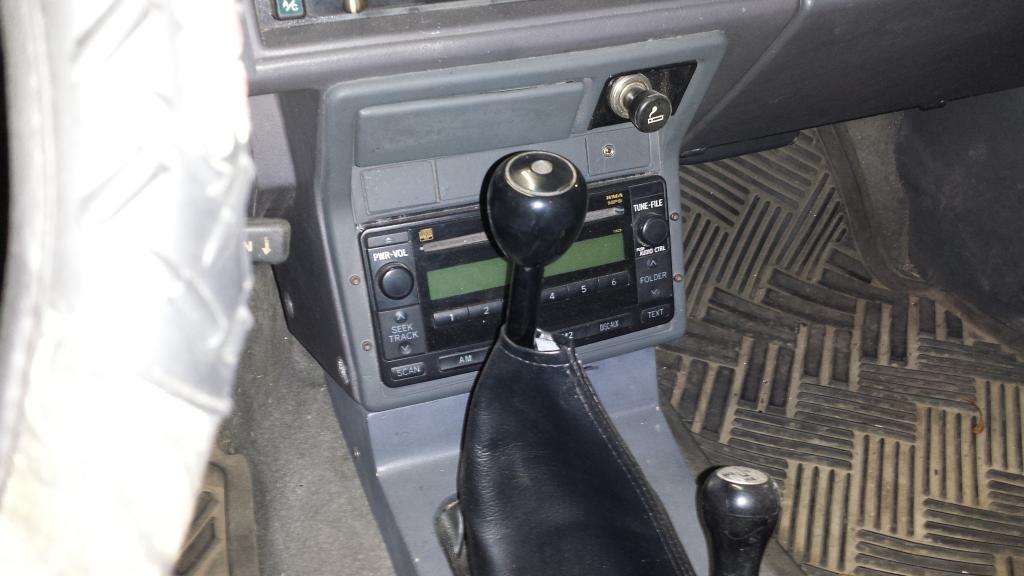

cheap enough when the radio was free.
08 fj radio in 1st gen

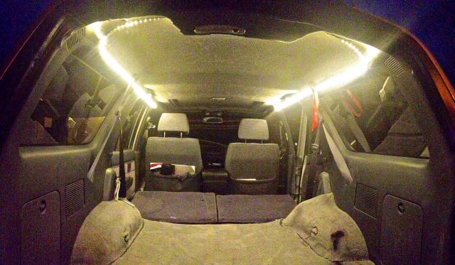

Got some LED lights going inside my 'Runner ... they are wired up to a remote control dimmer . About $20 total here...

Good idea. I might use it on my runner. Is it one led rope or multiple ones?
They're called LED ribbons , very thin , only about 1/4" wide , the strand I got is 16 feet long ...
Amazon.com: Lighting EVER Lampux 12V Flexible LED Strip Lights, LED Tape, Warm White, 300 Units 3528 LEDs, Non-waterproof, Light Strips, 5 Meters: Home Improvement Amazon.com: Lighting EVER Lampux 12V Flexible LED Strip Lights, LED Tape, Warm White, 300 Units 3528 LEDs, Non-waterproof, Light Strips, 5 Meters: Home Improvement

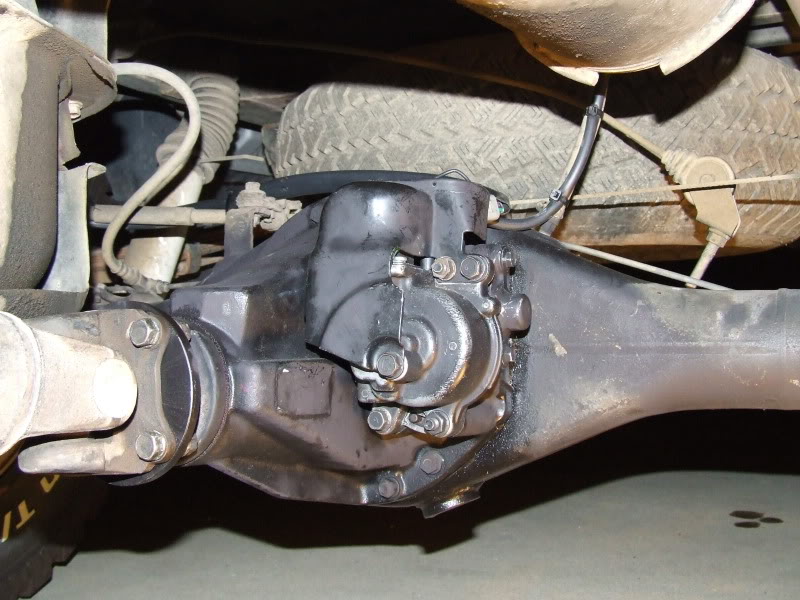

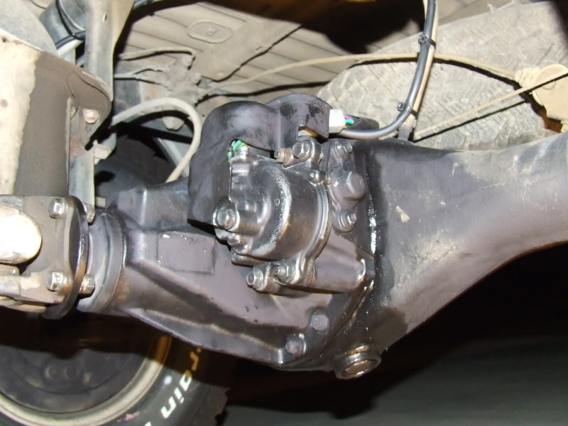

Another cheap mod I did.
I had a Toyota Electric Locking 3rd Member installed. It's from a 2009 Toyota FJ. I found it on Craigslist for only $50 bucks! Yes it fits. Had my gears swapped in. You just need to have two bolts holes moved and pound out the rear housing a bit. Best mod I ever did on my truck!
Now, it's like I don't even need 4x4 anymore! Cost me $600 bucks to have it installed and wired up though. But well worth it! These electric locking third members cost over $1,200 bucks new!
I have a thread on this somewhere here, under my screen name. On how to do it.

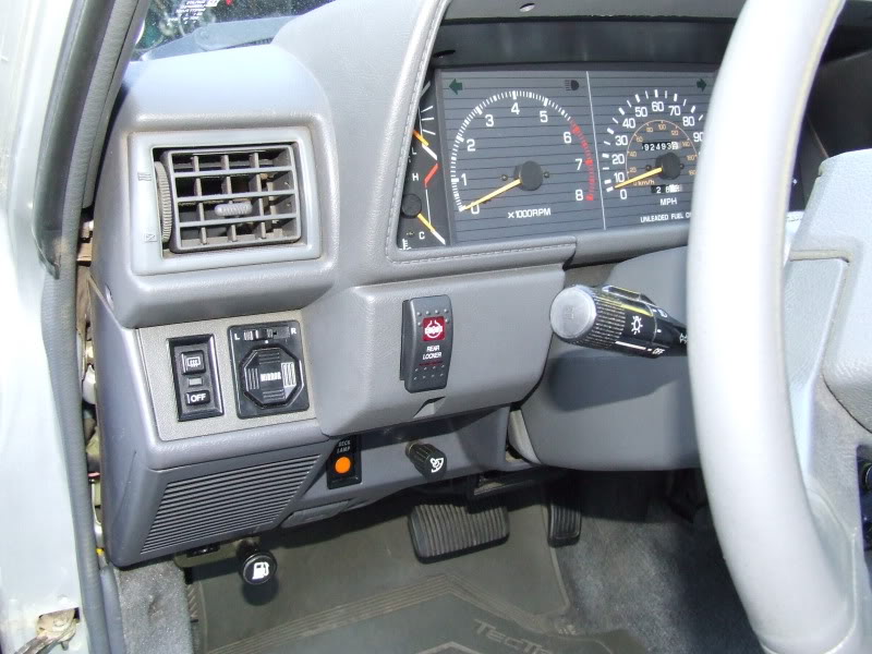

And I found this great locker switch that fits my dash perfect online for only $12 bucks! Looks factory!

Nice... Don't know if $600 is cheap though.
Now do yourself a favor and buy the bolt on guard for the locker motor. They are more then worth there weight in gold when a rock tries to reengineer the motor for you. http://www.lowrangeoffroad.com/elect...tor-guard.html

Thank you. Yes I have been looking into the rock guards. There are several on the market. And they bolt right on. I am always very careful on the trail.....notice no dents! Sweet! ; )

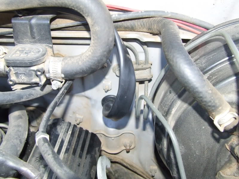

$600 bucks for install and wiring up to the switch was a great deal for me! It was the best deal that I could negotiate in San Diego at the time. And most mechanics had no idea how to do it!
He had to drill out new holes and weld shut the old ones. Very time consuming to measure and get the hole accurate!
I have a page for this install here on Yotatech.
My mechanic could not figure out how to wire it up in the end. So he had to send my 4Runner to an auto electric shop to complete the wire up to switch!
He said that made him lose money on the job! That's means that I saved money!
The wire pack into my firewall...... not an easy feat! From your rear axle!
It's the clean black flat wire pack going into my firewall. Just to the left of my master cylinder.
