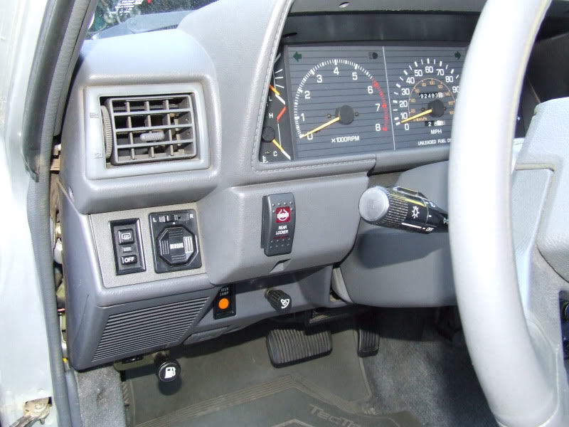

The wire pack fits perfect into the firewall!
The dash switch is Awesome! Fits perfect!
