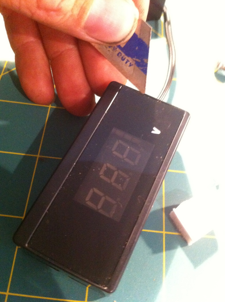

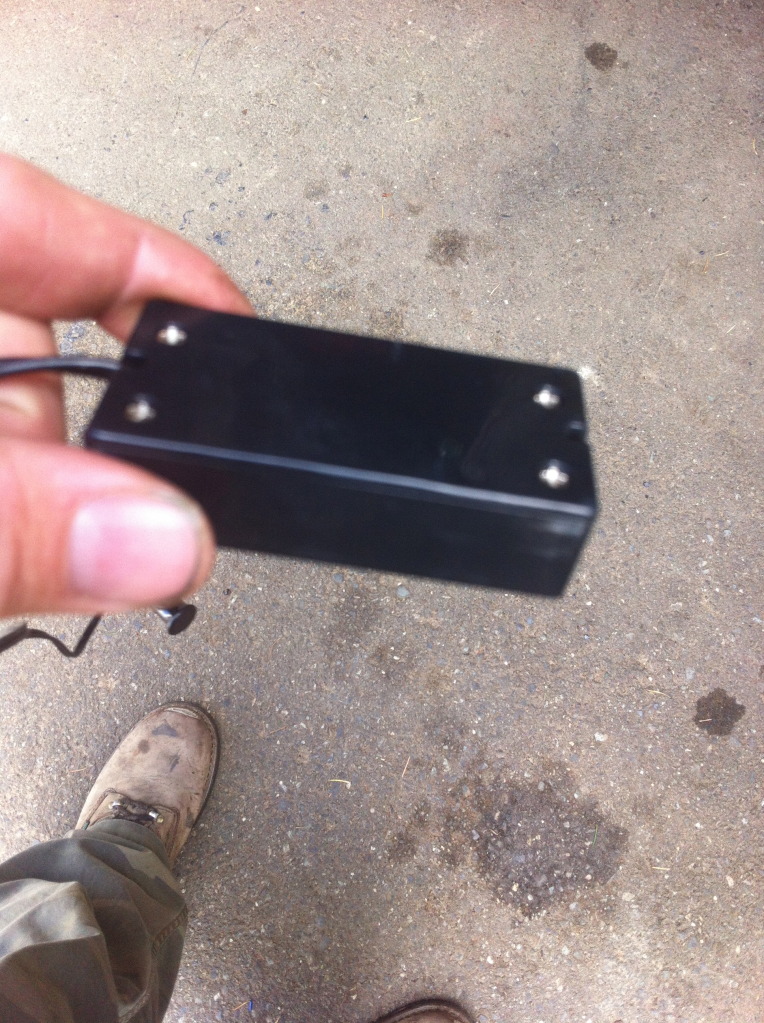

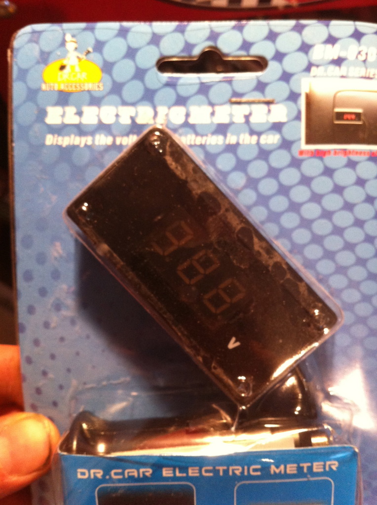

Voltage Gauge in taco
Picked up this little guy for $10
The face can be pryed off gently and reapplied elsewhere.
I trimmed about 3/16'' off each side to reduce the width of the face plate.
Removing the chip from its case allows it to be mounted easier in the space where I needed it.

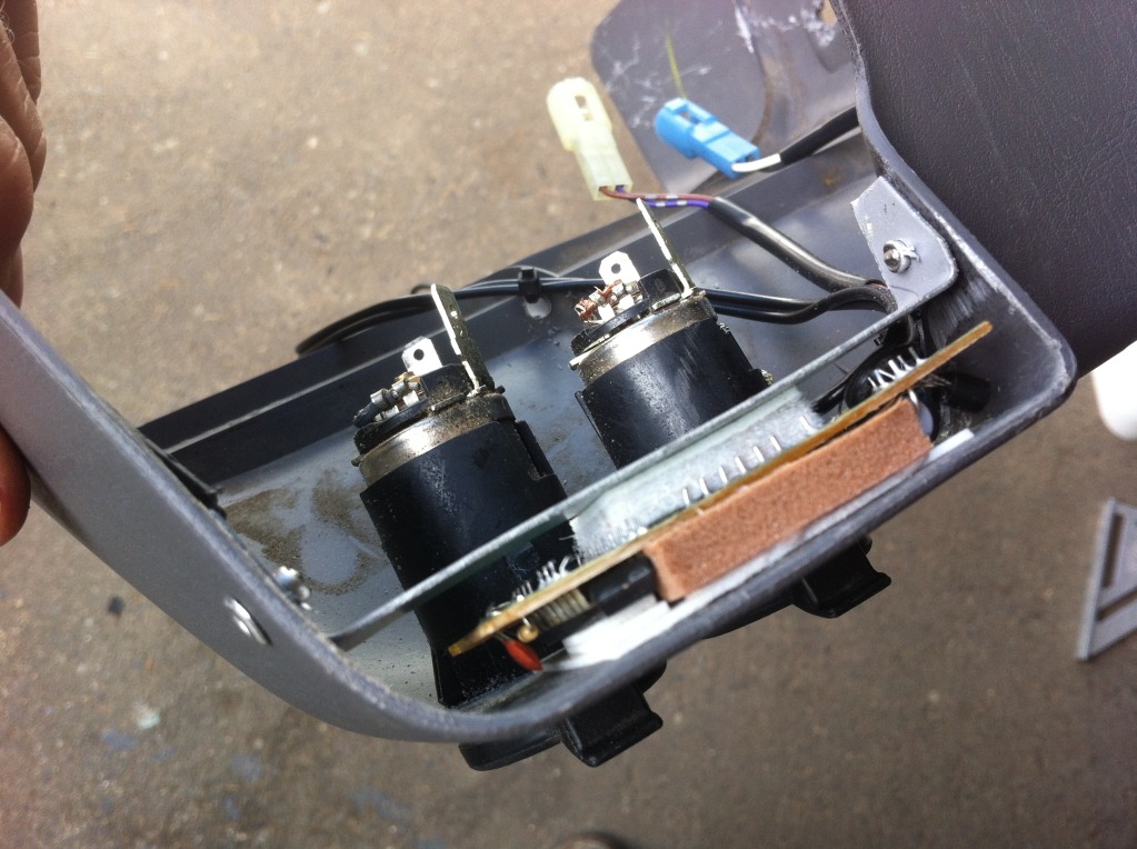

As you can see with just a little bit of double sided sticky foam and a peice of sheet metal and a couple rivets, this can be mounted fairly easy to the back of something. You will want to make sure that the screen is sealed off from dust. Cause once its in there it aint coming out.
Forgot to mention you obviously have to cut a square out of the plastic were your installing it.

I wired mine into the accessory circuit so that its on with key on, but it can easily be wired to a switch aswell.
This is such an easy and cheap mod that I went ahead and did it to my camping trailer.

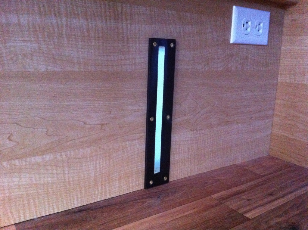

And while I was in there I made a plexi glass water tank gauge with led lighting,, well why not?
Tank is almost emtpy as you can see

That looks great. Nice work.

Wow, very clean install/great idea, ThatGuy!

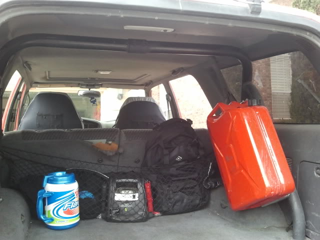

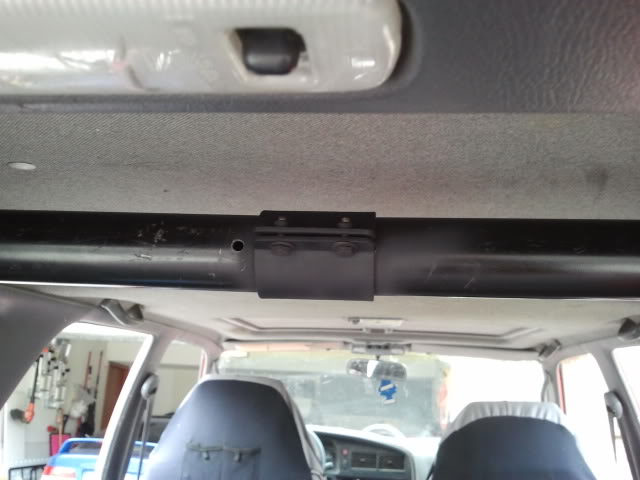

Got a 1st Gen roll bar or craigs for $20. I was putting it in myself so I cut it in half and used a pipe clamp where i cut it once i got it in. since it will only really be to hold a jerry can and hi-lift. On a side note the guy i got it from had a sick 1st gen bobbed 14" and dove tailed. Im trying to find the pictures

haveing a gas can in an enclosed space? bad idea, no smoking im guessing?

Ya thats a typically a no no... Kind of why nobody does that.
All gas cans leak some fumes.
Nice job on the retro, but id find a new home for that vapor box.
Unless your always running without doors,,, then it would be better.

I run the tube doors almost all summer long. It was kinda a last minute thing I was going camping and in the time I had, its all i could come up with. The only time its had gas in it was camping and when we got to the spot it was on the ground near the tent.
