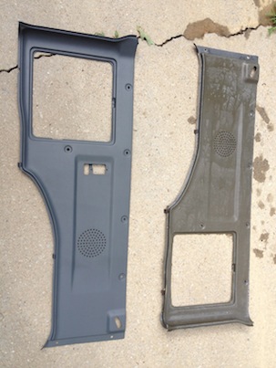

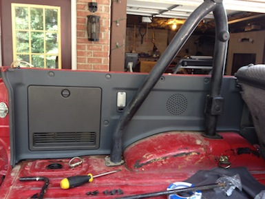

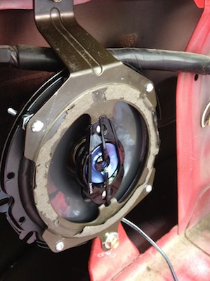

Replaced the rear speakers and re-sprayed rear cargo panels. The speakers sound great and the panels look like new again. The speakers are Sony 6.5" 4 way speakers you can get at walmart for around $40 and they mount perfectly in the rear factory mounts. The panels were sprayed with dark grey dupli-color vinyl and fabric spray and match the factory color very well (about $7 at O'Reilly). Sorry if the pictures aren't very good.

Wow, panels look GREAT, Dino! I have fresh UNCUT replacement panels for the back from Pick-Your-Part for 20$ ... But I'm planning on installing my sub back there, so just leaving my crappy panels for now, lol.
Looks great!

nice work... I want a set of those speaker mounts!

I just re-used the factory mounts that came in the truck. The holes lined up perfect for the Sony speakers and they produce good sound for a 6 1/2" speaker.

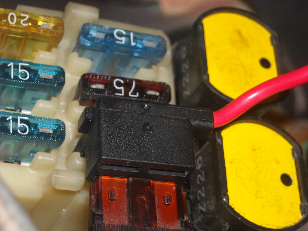

PERSONALLY, for now, I would wire up an 'Add-a-Fuse' tap in on the driver side kick panel.... I put mine in here......

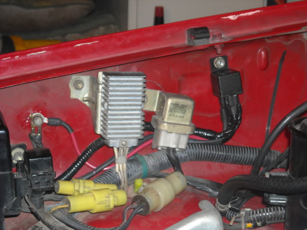

Then leaves, as rightly put by Wii.... "the switch", unless you want them always hot? I always start with the 'SWITCHED' spot, or try to, because then I can determine how far to the switch, how far to the battery from WHATEVER I'm trying to power.
I would also install a relay AND switch.... This means you'll need power from the battery to the relay... But you'll also need switched power(add a fuse line), a switch and wire to the seat(s).
Just look for a pic in google for "How to install off road lights with a relay and switch"... and just put the seats in place of the lights.... voila!
Here's where I ran the wiring to the switch(you want the switch running off that add-a-fuse so that it's not always hot... thus, it's IMPOSSIBLE to leave them on with the covers on with your ignition off...Key has to be in "ON or at least "ACC" position).....

Used a 30A fuse off the battery to the Relay for the constant hot wire....
Here's the relay I put in for the 'switched power' lights on my bumper guard.......
Shouldn't cost you much in the end... But I would NEVER run anything anymore without a relay, not things like this... That way, the relay and fuse from the battery to relay take the abuse and it is less likely to blow the fuse than when you run it without the relay... it's also gonna keep you from leaving the seat heaters on when leaving the truck... Which COULD LEAD TO ''TRUCK IN FLAMES" SYNDROME! Don't want that, right?
