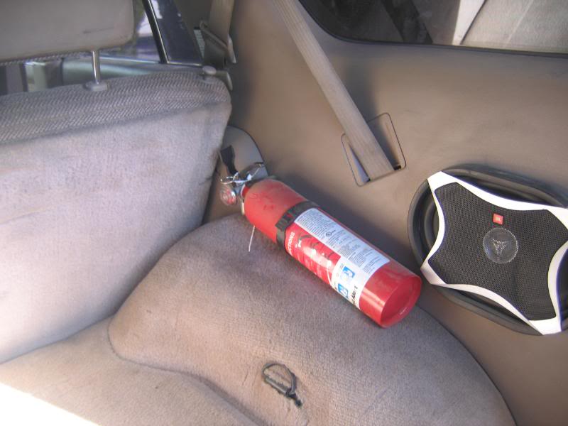

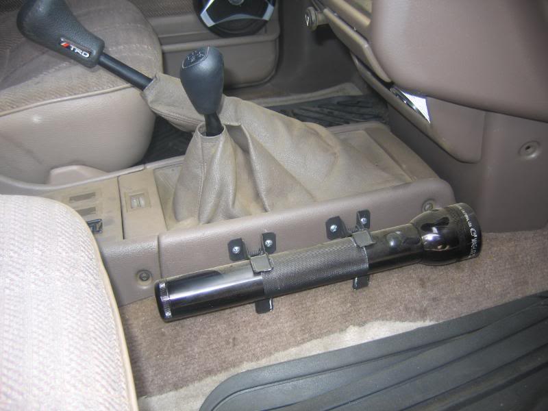

So finally did the Mag light and extinguisher mods!
Mag light-30$
brackets-2$
extinguisher-20$
Walmart!
The interior was dusty from the trail...very pleased with the outcome of these mods. Fun, easy, cheap and useful. If your thinking about it DO IT!

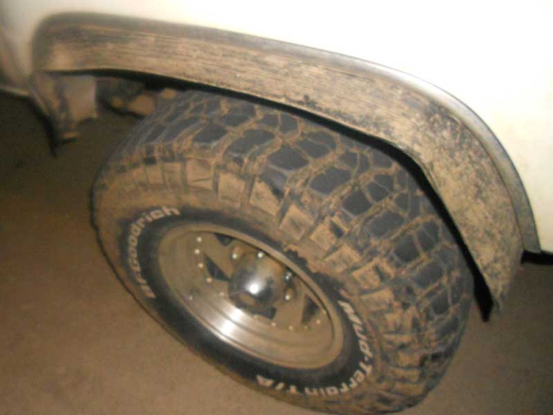

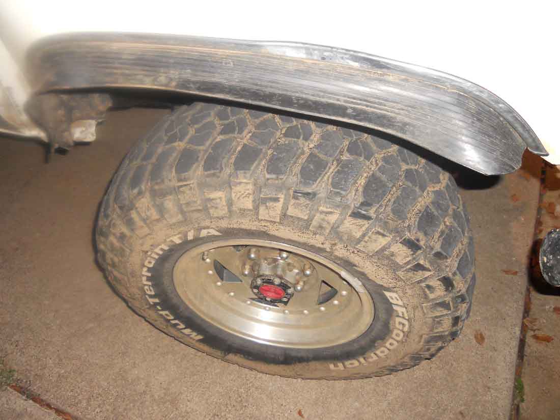

Thumbs up My Cheap-O Fender Flairs
Not $100's per side,
At Home-Depot get a roll of garage door 4" weather strip $12.95. A little sheet metal cut into 3/4" strips about 3' long, some self-taping screws and washers I already had and presto!
However with the Texas heat they tend to droop after a couple of summers.

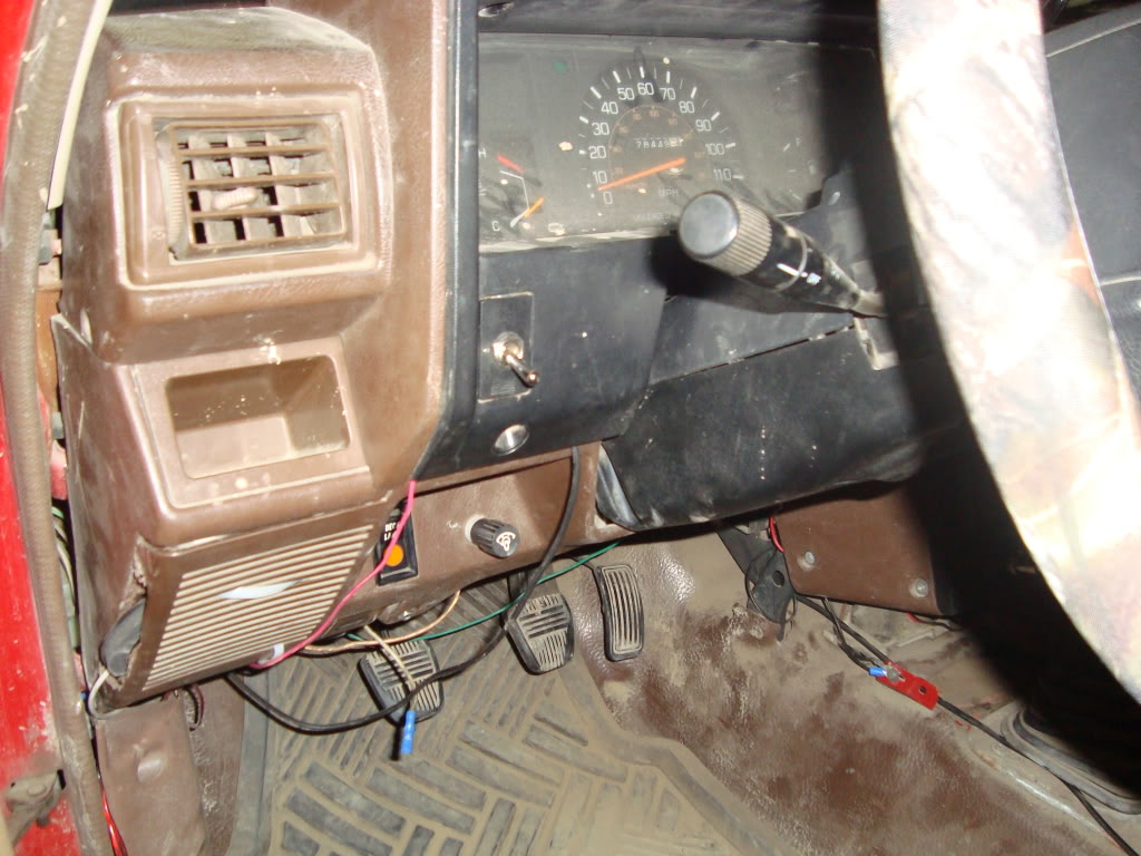

well i got my lights all wired up and workin

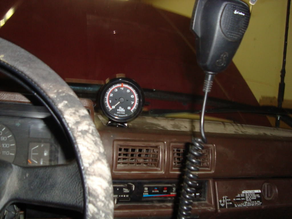

my tach in but not working yet

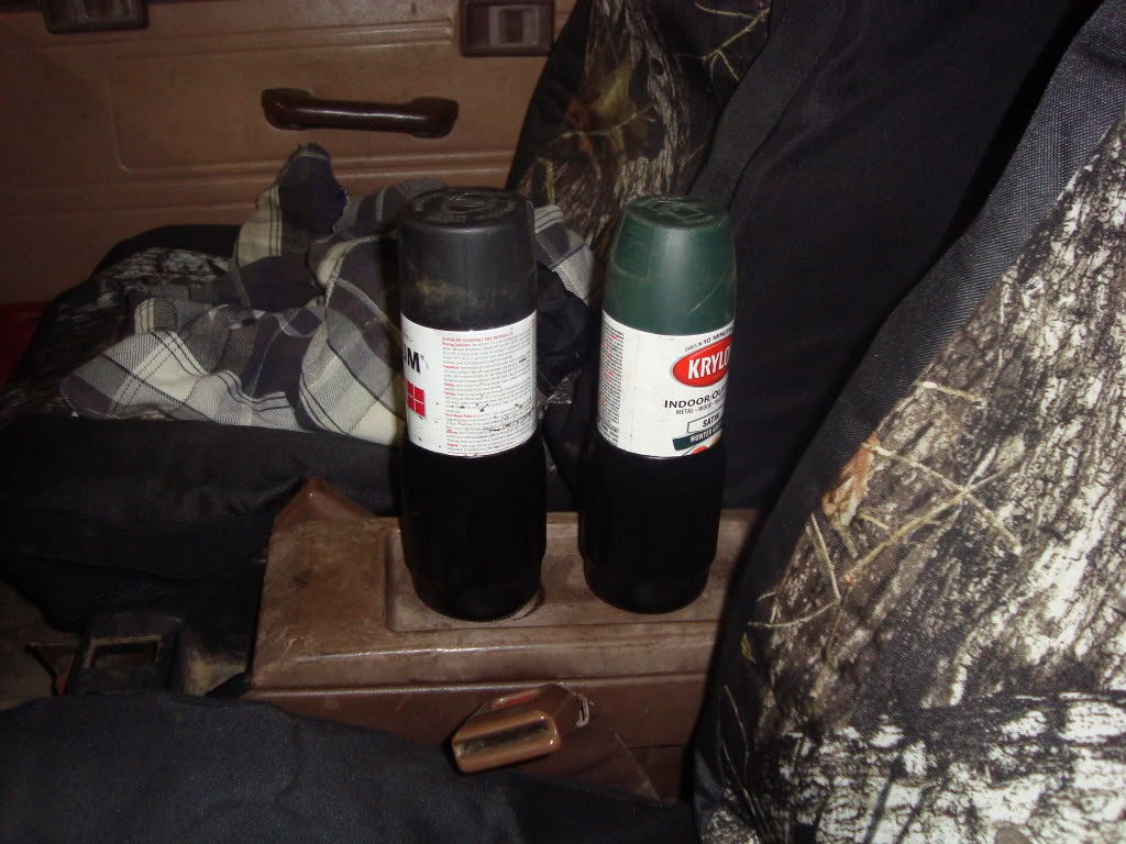

my cup holders in
