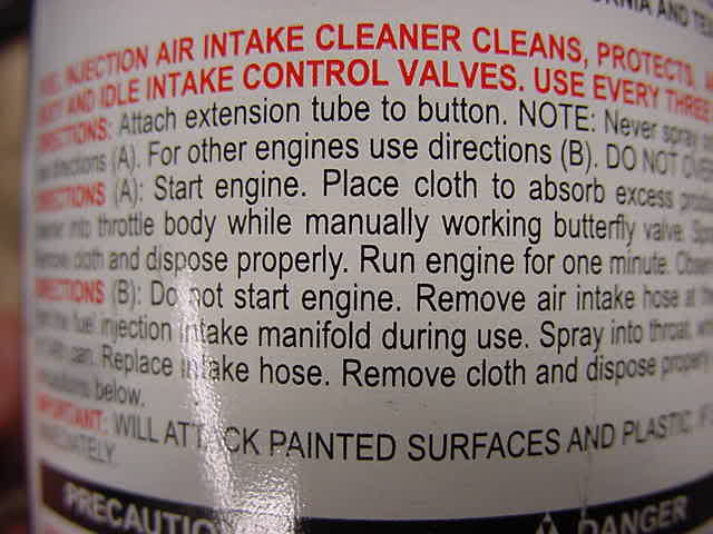

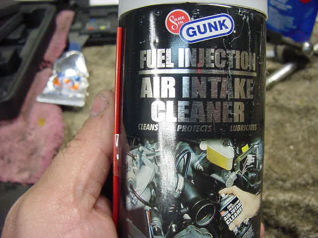

What you guys have beeen doing with Seafoam in the intake plenum is very similar what I have been doing with a spray can product that I get from BAPP IMPORTS....can't remember the product name but will post a pic maybe tonight.

I spray the whole can in the intake plenum.....seems to smooth out the idle. One of my tricks I use just before taking it in for emissions
