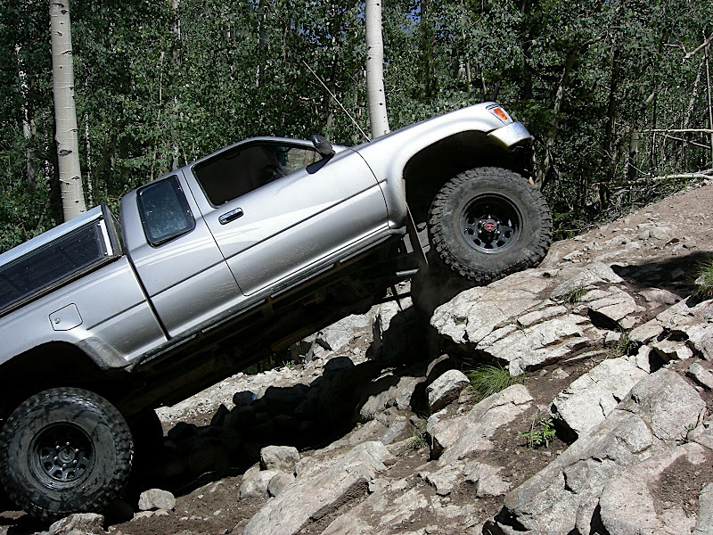

Here's mine with 33x10.50's. I'd love 35's but I'm replacing my balljoints, tierods and Idler already after about a year of wheeling... 35's would abuse those parts even more.
In the pic you can see the kicker bars that go from the transmission mount to the LCA brackets. Those are the only difference between Stage I and II. Definitely go II though as I've read some bad threads about the brackets bending without them. (AxleIke i think)
Here's another so you can see fitment on level ground:
