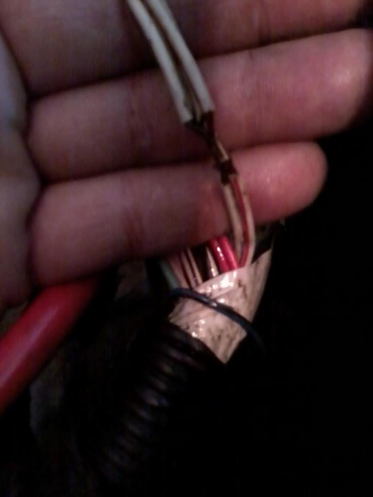

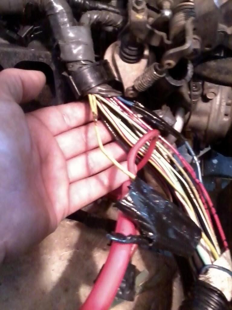

I have seen the injector connectors on these get bad. With it idling, try gently tugging and pushing on the connectors and see if that causes any idle changes or misses. My need to use a pair of needle nose pliers or a wooden dowel.
Another issue I see that causes problems is in the injector wiring harness. Two injectors share the same wire. One is a blue wire and one is a yellow wire. Toyota uses a poorly designed crimp to combine the two injectors wiring together. If you look at my 86 runner build below, on the last page or recent post, today I just removed the crimps and soldered the wires together.
Copied...
Here is where I removed the crimp on the yellow wire. The blue wire runs two other injectors.

Here is the two ground wires that all come together. I wasnt sure I could get all 4 soldered together so just cleaned them up and re wrapped them.
Here is the small little crimps in the harness. A poor design and is just wrapped with electrical tape from the factory.
