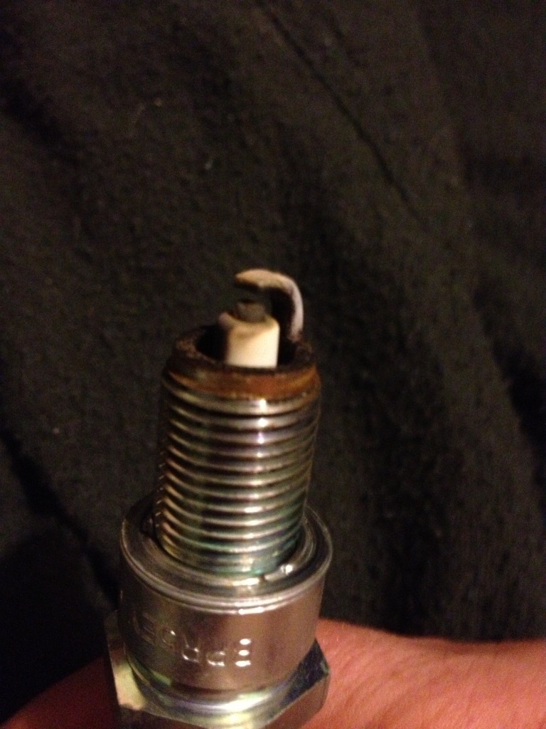

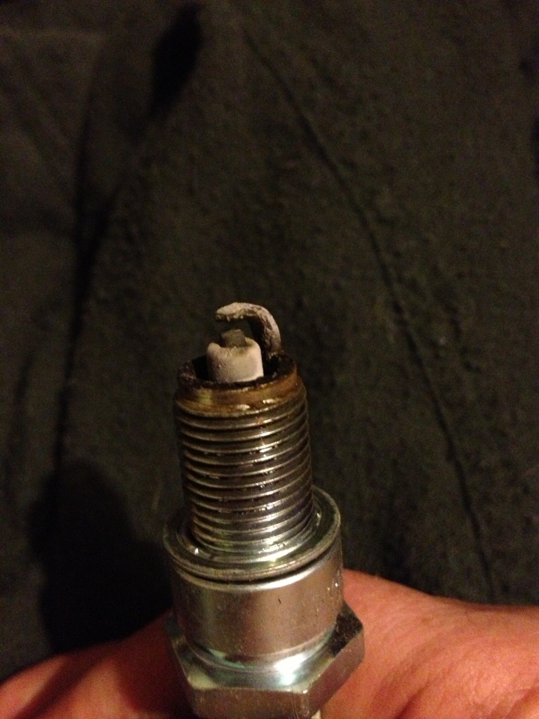

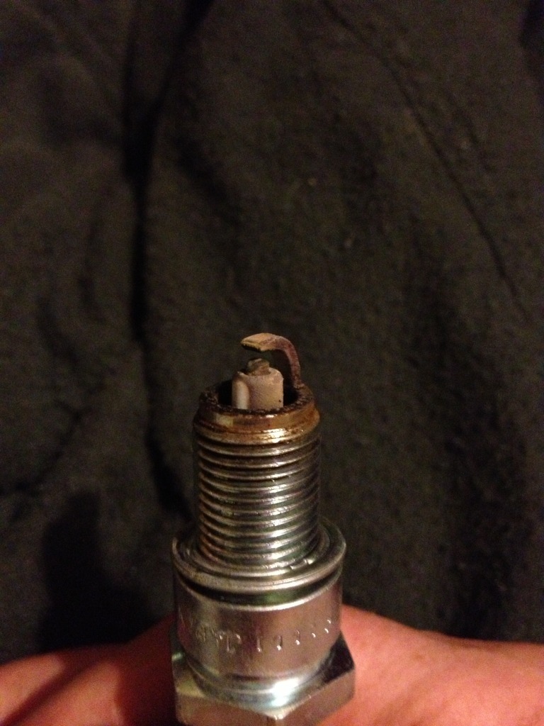

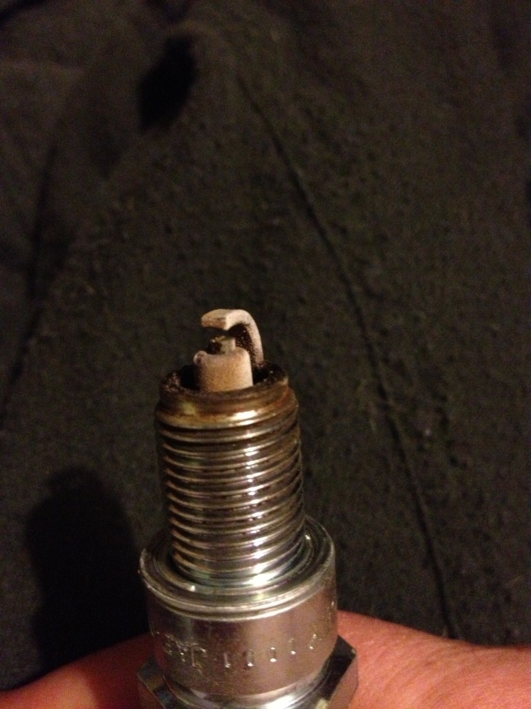

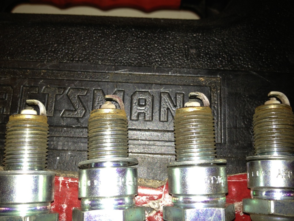

So to eliminate the easy fixes, I replaced plugs, wires, cap, and rotor. It's better, but I still felt a slight stumble when under hard throttle up the uphill on ramp where I noticed it first. Rechecked TPS, it's good. Timing dead on at 5* BTDC, check connector jumpered. Dead on 8* removed, advances and retards smoothly with decel/accel. Here's the plugs, look ok to me, anybody think different? iPhone only gets so close with pictures.
All:
No 1:
No 2:
No 3:
No 4:
So tomorrow, if I get up early enough before work, I'll check out the VAFM per 4crawler's write up, and maybe give it a couple hard throttle pulls, and see if it's still there.

you replaced the plugs, since they were already out, correct? they all look like they are firing, fwiw.

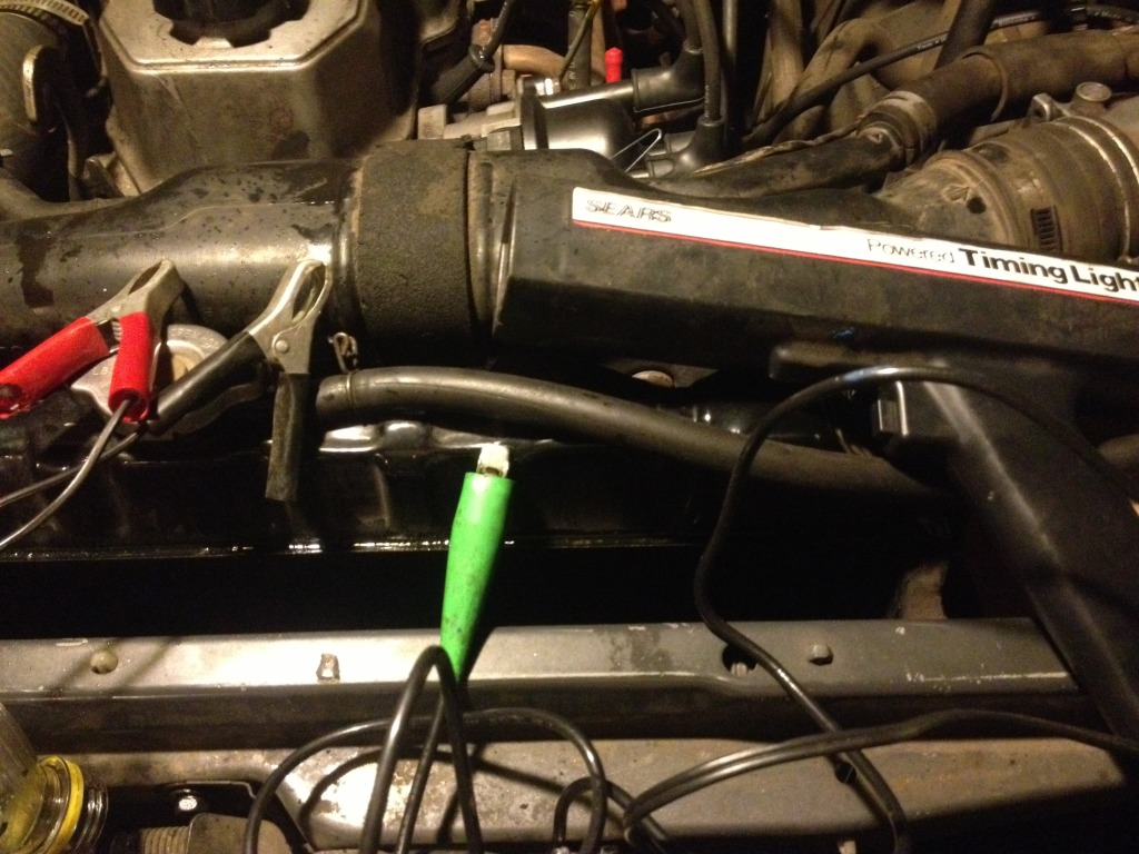

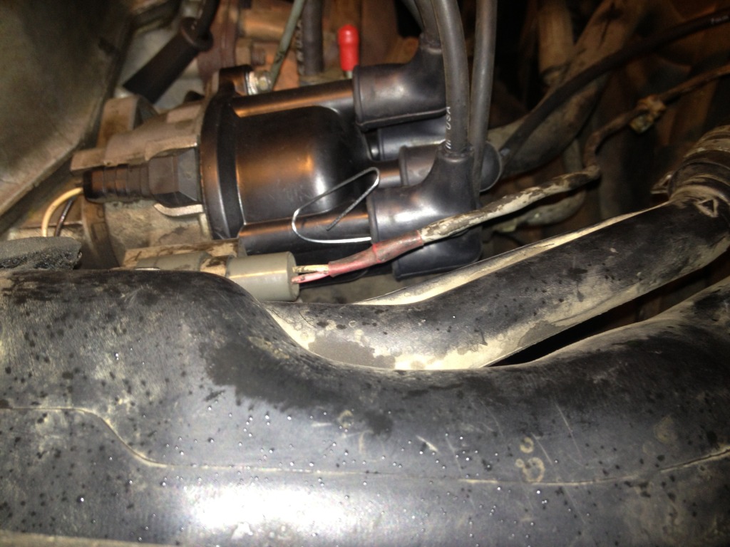

Still no closer to a fix. Ran it down to North Bend and back home, pulls hills and cruises just fine. Stick my foot in it, still a hiccup at 2.5-3k, not an ongoing stumble, just a single hiccup, and on down the road. Did oil change, filter, and coolant flush and fill today. Rechecked timing, used an old gun for it. Waaay better strobe, and I think it's dying, wouldn't always stay on. But it told me I was a degree or two advanced from what I should be. Here's the hookup. I used this when I was a kid, no idear how old it is.
Had to use a paperclip under the boot, as I couldn't find the spring that goes on top of plug, under the boot. It works. Pretty damn well, too. Thanks, old farts that gave me the idea.
As I was re-timing it, I could see the mark wandering, even with E1-TE1 jumpered. Anybody else think that ain't quite right? Not a bunch, but a half degree to a degree. Maybe I'll try getting some video, if that doesn't make sense.

it wasn't perfectly steady when I set it on mine, you kind of have to wing it.
the spec is for the timing to be set at a certain rpm... I got a new timing light just so that I could do that, because it including a tach... it was reasonably cheap.
there is still something wrong with your distributor setting, because there isn't any room to turn it, to advance the timing... that is not right.
Well, there is room to advance it. Just not a lot. Most of the distributors I've seen sit around the middle of the slot for advance/retard. And most of the stuff I've set timing on doesn't have any variance in the mark. The 76 351W I used to do would sit rock steady. Same for the old 360 and 390. It may be a distributor issue, I think the things made about 700 billion rotations, and the bearing seal doesn't look so great. I'll figure it out, just posting to keep things updated. Most of what I found for threads just kind of die, with no solution or results on a fix. Kills me.
