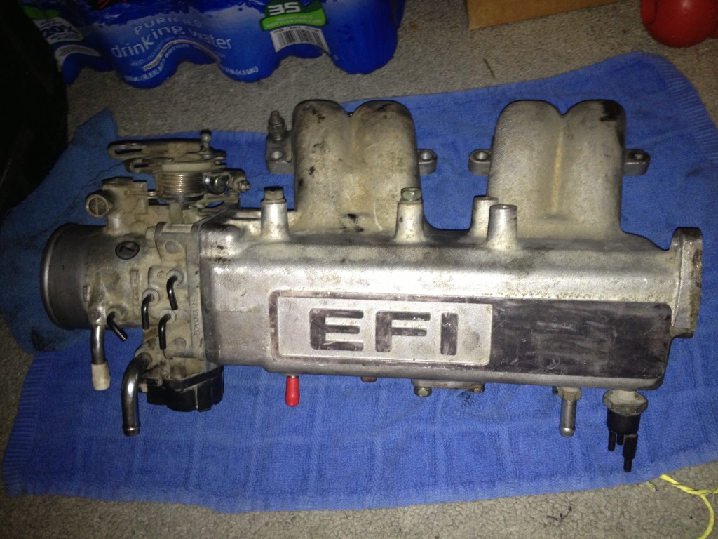

In the ongoing checklist of things to fix my stumble issue, I decided to remove and clean my TB and upper intake. Here's the back of the TB.
It needed cleaning, and the gasket was out of position. Looked pretty original, and was pretty hard, so I wonder how long it's been messed up. Looks like a poor install. How long ago is the question, since I know it's never been off since 97, when my dad bought it. I also discovered LOTS of oiliness in the intake runners, I've had an oil smell on decel ever since the engine I put in in early 09. Doesn't burn it, and never smokes. But the oil does go away. Maybe this is where, but how, is my question. Valve guides?
Anyway, off to clean out upper intake, need to pick up TB gasket, too.

Should have seen the crud that came out of everywhere when the pressure washer hit it. Amazingly, the EGR passage wasn't completely clogged. Didn't get any pictures of the cleaning action. Too dirty to grab the phone. Got new TB gasket, now to set up TPS via 4crawler.

All put together and ready to go on in the morning. Knechts had the wrong gasket, didn't cover the bottom portion of the gap. So off to Autozone for the right one. Set up TPS, reinstalled the dash pot I removed forever ago, (due to sticking) we'll see if it still does it, backed the stop screw way off so it just makes contact before closing fully.
I'll have to keep an eye on my oil usage/loss situation, see if I can figure out where it's going. No leaks big enough to use it at a quart a month.

Got it all back together. Had to adjust idle, so checked timing too. All checks out. Right now, after a shakedown run, it seems to have fixed my stumble on acceleration. I stress that it was only a shakedown run, so it'll take a few days to know if it's gone or not. Wasn't always able to make it happen. Pulled hard, about 4 or 5 times, let it decel, little loop thru town, and pulled up to a stop, started idling like I had a cam it, down about 500rpm and loping. Took a minute, adjusting the idle helped, raised it a little bit. But now it's got a funky miss or sputter at idle. Smells rich, too. Fuuuuuuuu... Now something else to chase. Runs good otherwise.

Well that's weird. But not really. I should have pulled the IACV off and cleaned it up. Gave it 30 minutes or so, started up with a bump of the key, warmed up, idled right where it should. So I deduce that my IACV is in need of some love. Disconnecting and reconnecting it may have something to do with it, air bubble, etc., so I'll leave it be, and see if it reoccurs in the next week or so. Got a trip to coast soon, hopefully I'm not stuck on 126/101 somewhere!
