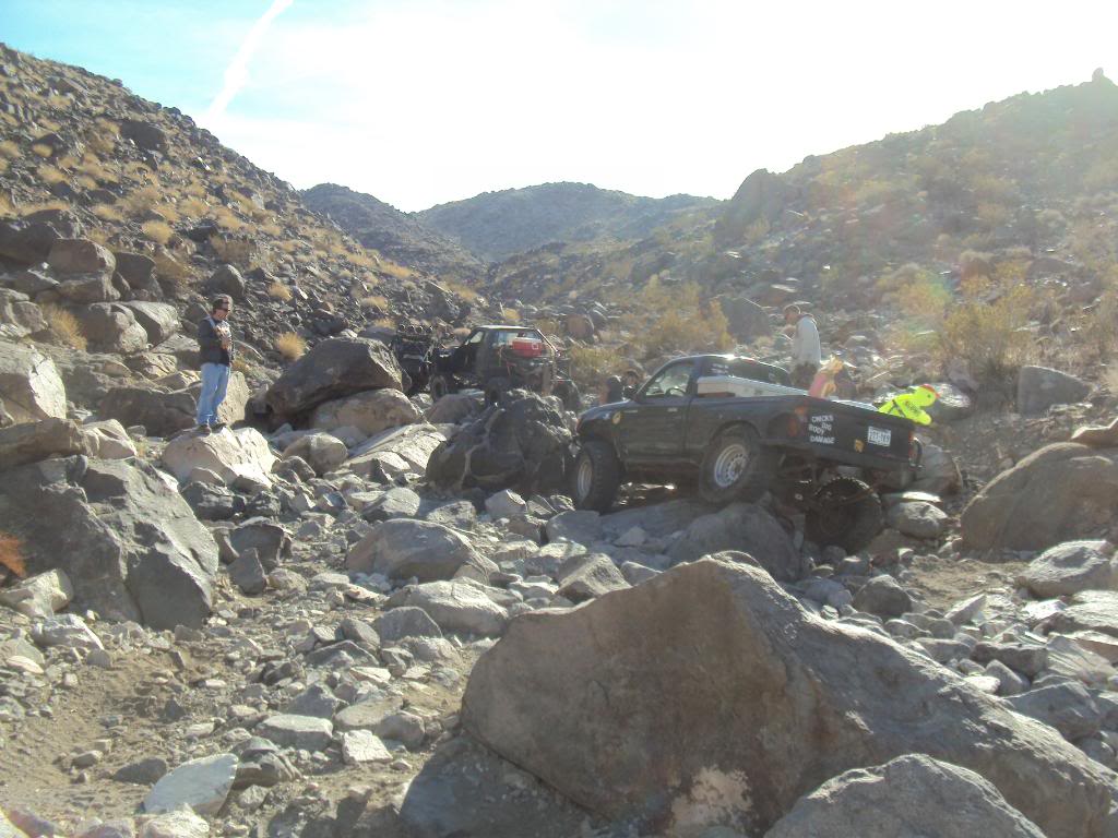

Bracket lifts gain absolutely nothing other than 4" lift. Nothing. Absolutely no gain in travel when done properly. ie bump stop extensions. IMO not worth the money. For $1100 on a good Bracket lift (procomp stage II), most people can go SAS for a few hundred more. That $1100 when put into proper mods (NOT SAS), an IFS truck will out wheel a bracket lift any day of the week.
Who needs experience when you got a guy on a 2.5-3" spring lift running 35's and no bracket lift. Yes he had to do some work to get the 35's on the taco, but work is free and $$$ on huge lifts is overrated.
Can a stock suspension on a $1000 4" bracket lift with factory travel amount do this on 35's? Even with Lockers? I don't think so. Oh yah and a 4" Procomp bracket lift for a taco runs about $1800 with shocks. And those idiots only say it clears 33's. Ok yeah whatever. Anything to sell more of your stuff and take advantage of the mall crawlers.
