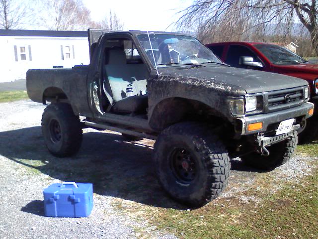

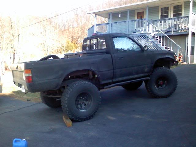

save yourself some money and get 1.5in bjspacers, a 2in AAL or shackle or block out back, and a 2in BL and run 35s alllll day. aaahhhh crap i forgot, if you get a bodylift, youll die and your taxes will go up and your babies will be born naked. but seriously, those bodylift block are EXTREMELY flammable and combustable and EXPLODE!! jk
then cut you fenders, like i did if there rusty, and never look back
