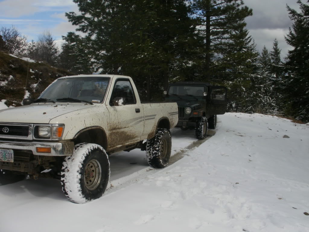

Just run a 2in BL and 33's until you feel you need more
and cut the IFS off.
here is my rig with 2 in BL and 33x12.5s
Works great.
