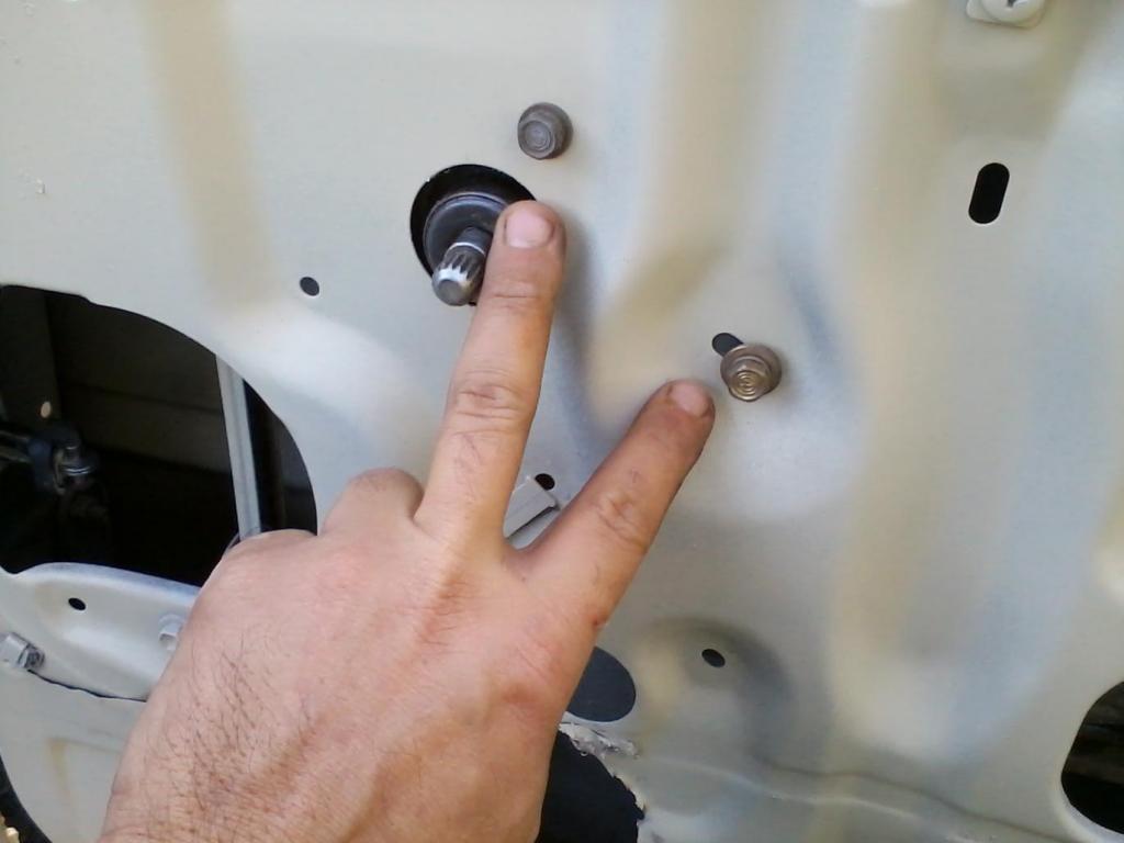

To install the window lift assembly, I loosely installed these bolts first.

Then I worked the window and the slider assembly to where I could get this bolt in. After I got all the bolts in. I rolled the window up tight and then tightened all the bolts that hold the window assembly to the door. After that I rolled the window down and tightened the bolts that hold the window to the lift assembly.
