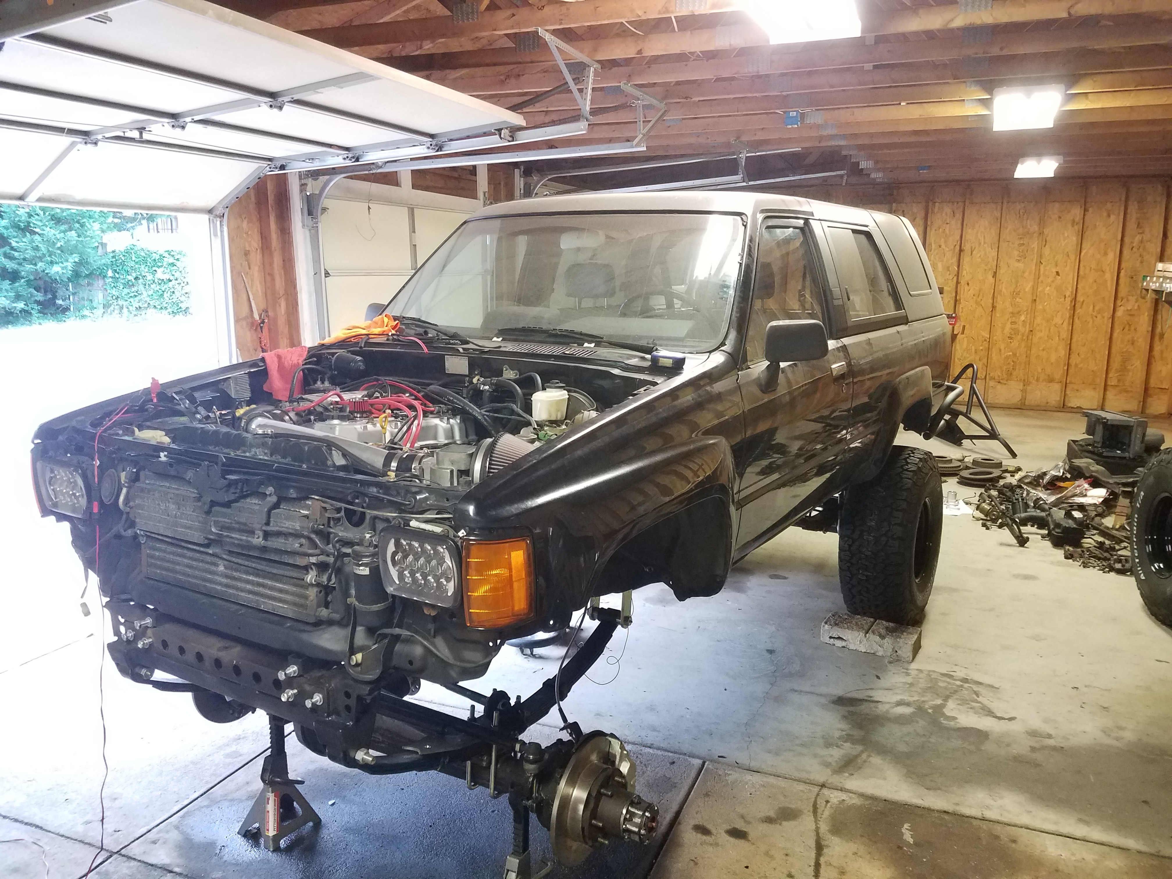

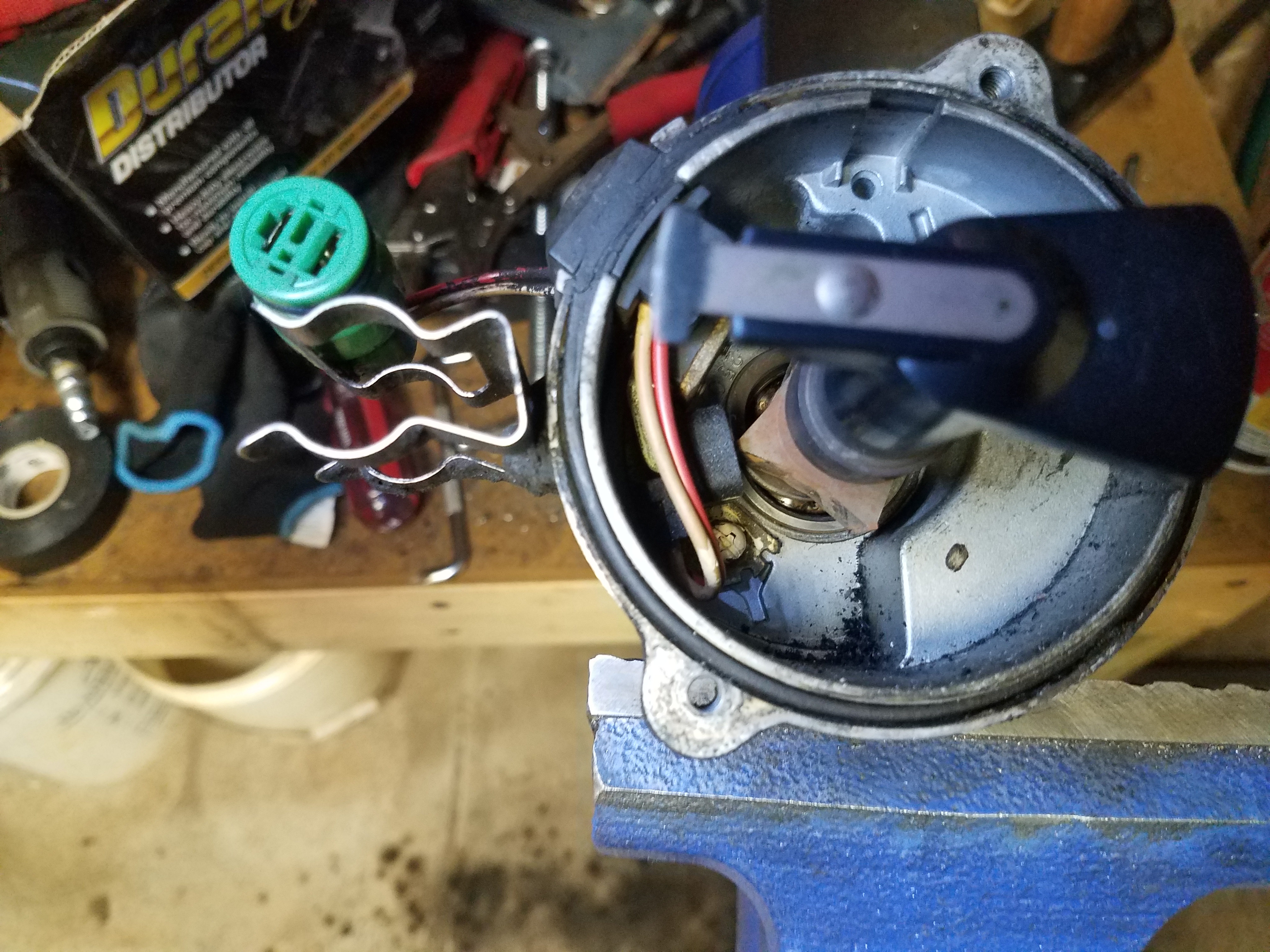

Thanks for the diagrams RAD. I'm out of ideas and have replaced pretty much all the components. Coil, igniter, ECU, ignition switch, distributor, spark plugs (more than once), battery, all fuses, tested all relays. I didn't replace the AFM or the TPS as I was told that neither of those would keep the engine from running... is that true? If not, I'll be replacing them. Any ideas what to look for next? I'll post what I find out about the injectors likely tomorrow. I know the injector plugs are sending power during cranking/starting as I tested with noid lights. Is it possible I'm losing the injectors AFTER it starts for some reason?
Here's a couple pics of her sitting.... and the distributor. You can see the bearing seal/cover has come off and there was all kinds of metal shavings, like powder in there sliding around when I shifted the distributor... glad I got a new one even though it didn't solve the issue.
Attached Thumbnails Engine won't continue to run-20180604_193750.jpg   Engine won't continue to run-20180604_222337.jpg
