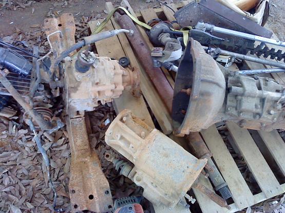

ok i am adding a dual t case setup with 23 spline tg adapter and tg gear reduction for the rear case and i need to know how to tell the differnce between a top shift t case and a forward shfting t case and pictures would be awsome if any one has them..

top left is the fwd shift and the bottom is a top shift pretty postive about that if im wrong please let me know id hate to tell someone the wrong info???? btw these are 4 sale$$$$$$$$

on a top shift t-case the shifter comes out of the top of t-case all by itself.
on a forward shift t-case the shifter comes out of the top of the tranny directly behind the transmission shifter.
hope that helps
