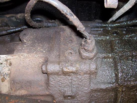

Theres also i plug i noticed on the tranny almost right where the tranny and t-case join i think, my other truck doesnt have it. Anyone know what this is?

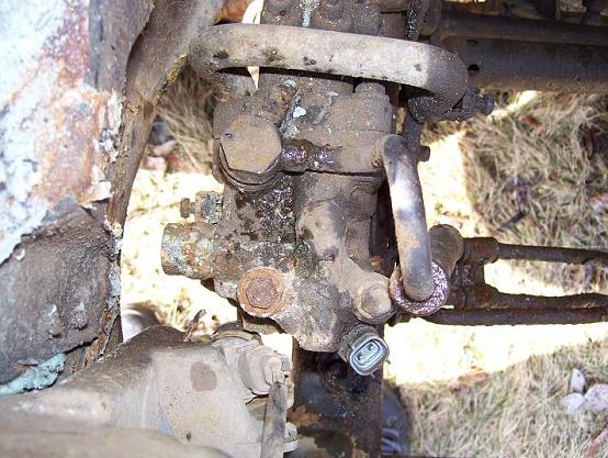

Heres a pic of the box on the frame rail and the sensor on the tranny that is not on my other truck.

I wondered if it was for the abs but found it funny it has lines running to the power steering pump. If this box was for the abs could i do the same as the rear and just leave it unplugged?

Originally Posted by 87toyy
The 91 has a box on the passenger side frame rail that almost looks like the power steering. It has lines running back to rear of the truck and lines running to the power steering. Can anyone tell me what this is for? Can I get rid of it? It has a plug plugged into it that the other cab doesnt have so i dont think i can plug it in.
Originally Posted by abecedarian
pressure from the ps pump is used to override the rear brake pressure thus causing them to act as if they were being released.
Power steering pump surgery question(s)...

oh shucks dude... I just remembered...
You said one truck was 22RE, 5 speed AND ADD?
That's the G58... And it has a chain driven case... You can look at the C/T A/Tm code in the door jam or under the hood to confirm, but it's a waste of time...
That might have something to do with that extra wire... No, that is it. It tells the sillynoids to open and pull a vac on the ADD to lock the axle.
Trouble and check engine lights being on is crossing my mind right now...
Good luck... B/c you will need it...
