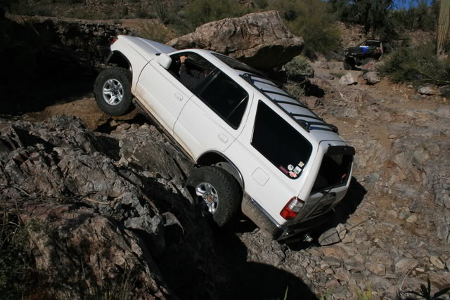

Sonoran Steel put to the test again this past weekend. Miner's Revenge, AZ
On Martinez Canyon
You won't be sorry.
