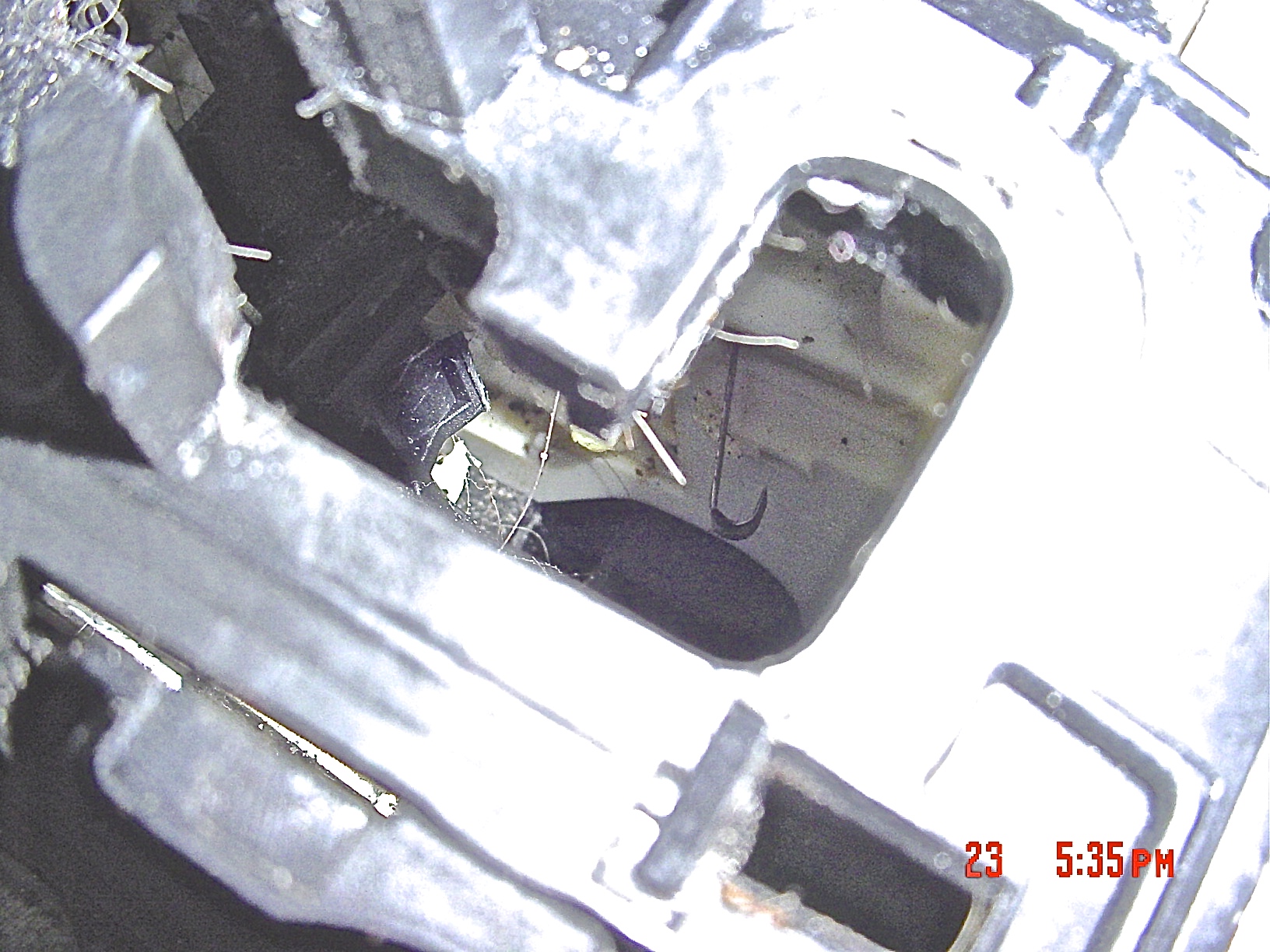

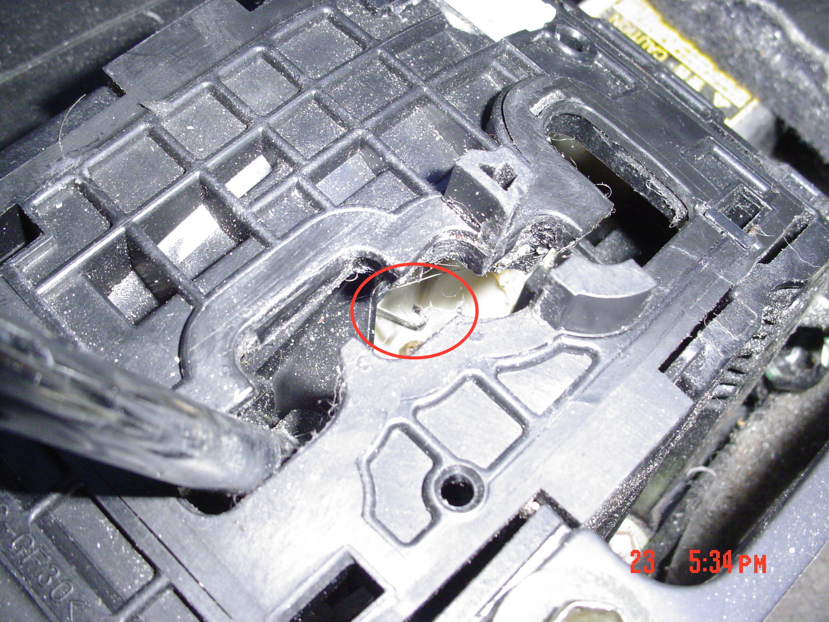

'03 4Runner automatic shifter loose
hi, I've suddenly got a L to R wobble with my gear shift selector especially 3rd to Drive. I've gotten down to removing everything and can see a SS tension? clip with a hooked end on what I can see, did not see any springs or broken plastic in cavity below and am wondering if someone can tell me before I remove the black plastic "lid" to see where this clip might go is there anything that i will have to be very careful of under that lid piece, it's held on by a shift lever lock pin and shift lever lock nut. Any help would be greatly appreciated asap due to appt at dealership who usually know less than I do thanks to these forums and their members.

Are you saying that..........
Originally Posted by Hrddrvs
Ok, are you telling me that this has nothing to do with the shift lever guide housing inside the 2003 4Runner and that what needs to be done is underneath it from the outside ?
If so then what is the piece of metal, flat with hooked end that is obviously out of place inside the shift lever guide housing ? And last is the shifter lever doing nothing more than controlling the cable ? which is the reason you sent me to the link re fixing this problem from underneath ?
Thank you for the reply and your help. Hope the pics make it.
SeanCeltiad

I did'nt realize you need info on a 2003.The link I posted is for 86-95 trucks and 4runners.Try the 4th and 5th generation trucks and 4runners forum on this site.Best of luck.
