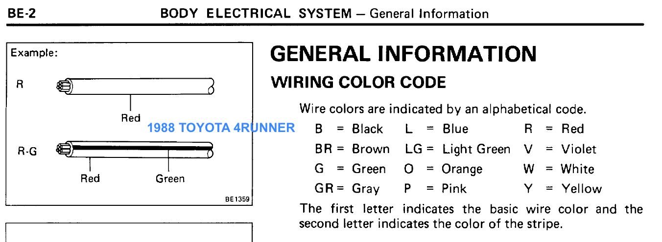

Start with this, and report back. This is from 198 4Runner. Wire color code should be same as 1987's
