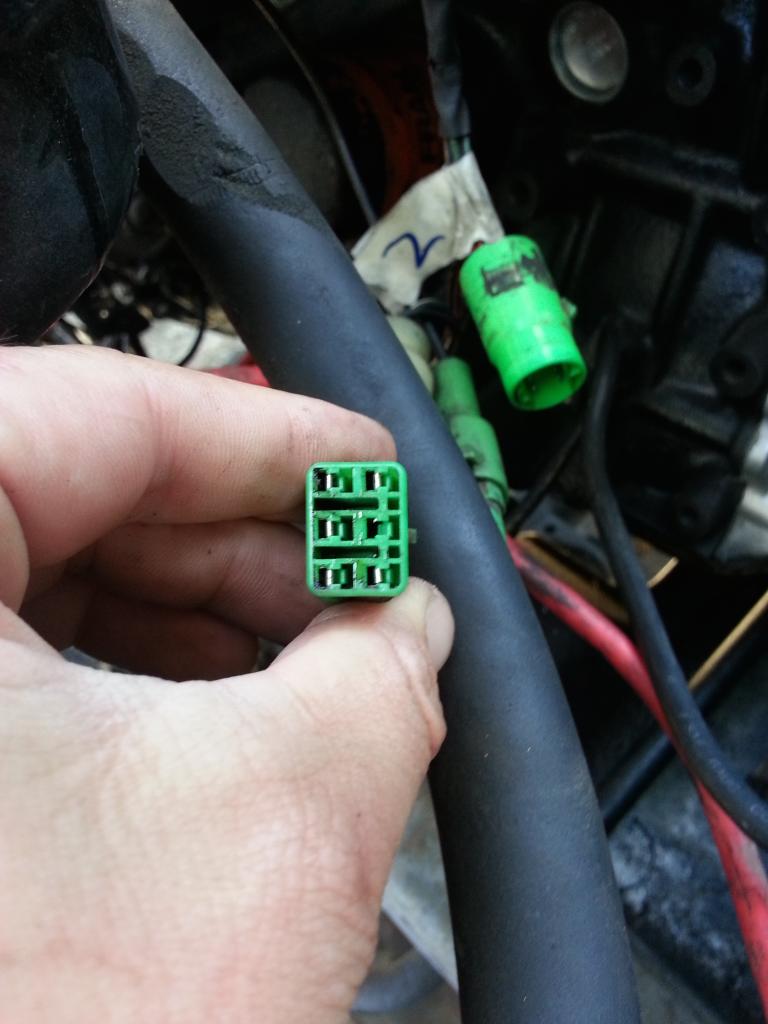

Thanks for the reply Wyoming. This is what I am missing.

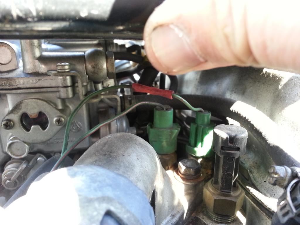

First is this 6 pin connector
That connects to these two smaller connectors under the air filter: Name:  20140817_125122_zps980cc405.jpg

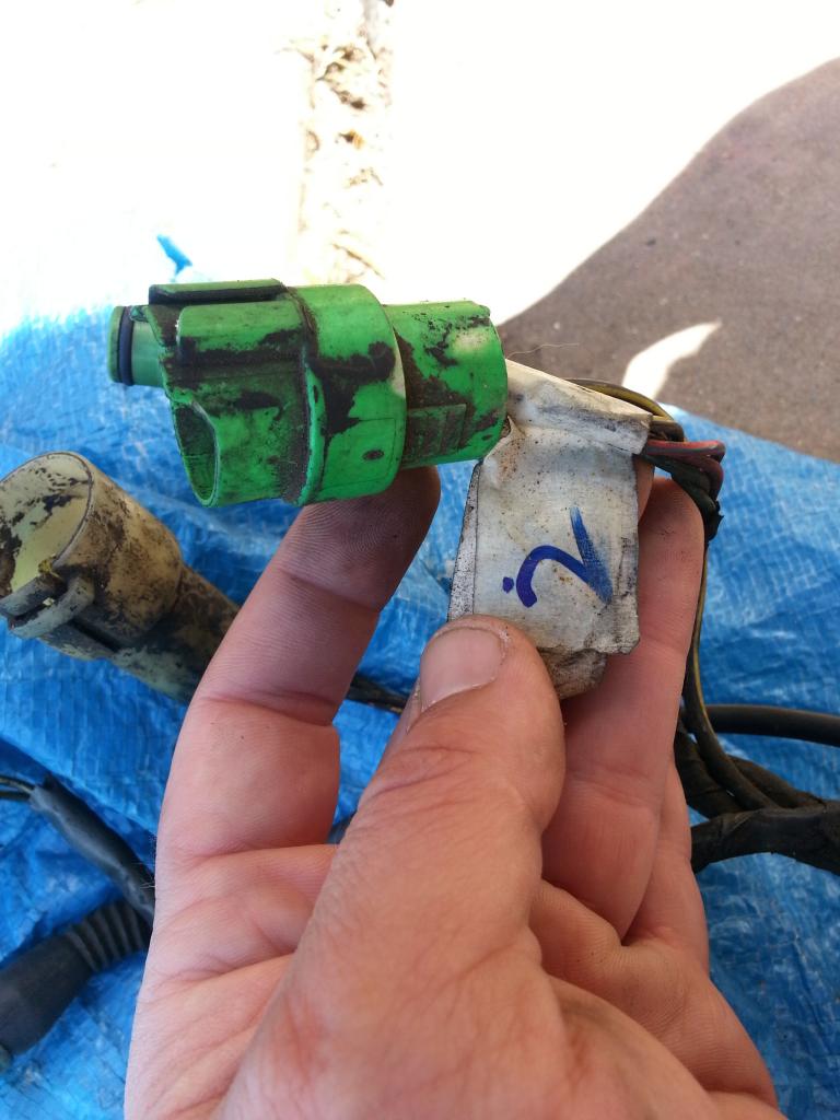

This is the spot on the old harness for this connector:
I think this may be what I need to connect, but the coupling is different, this coupling on the harness is a 5 pin, and the old one is a 6.

But what is it for??
Does it go to the temp sensors on the thermostat??
Toyota is known for changing things
Looks like you have the correct plug for the 87 harness The other end is still on the engine more then likely
I hope you have the ECU for the new Harness!!

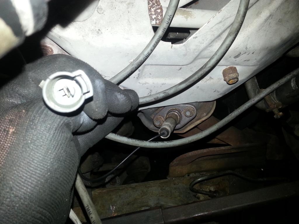

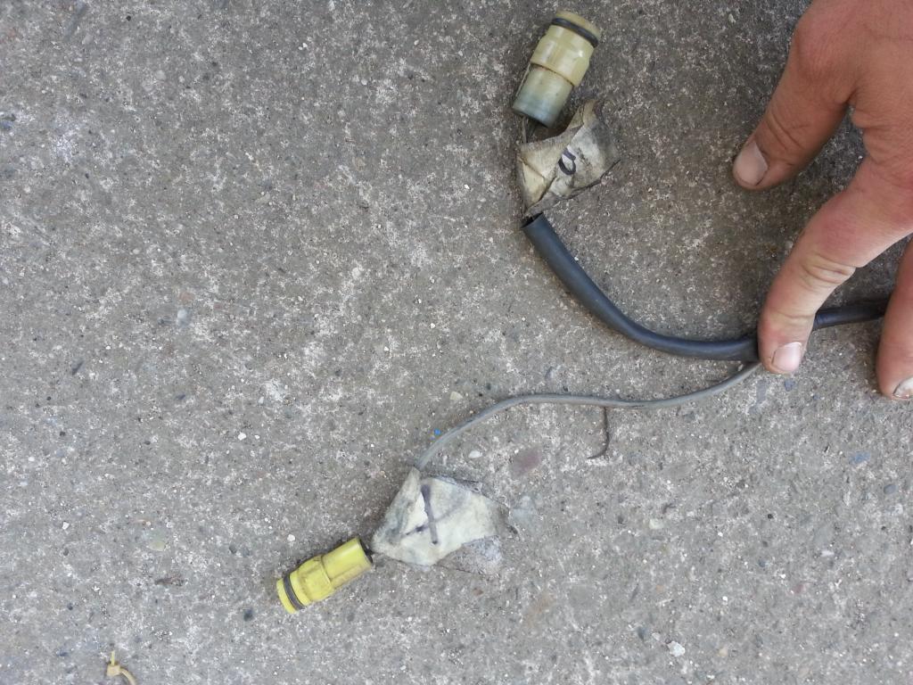

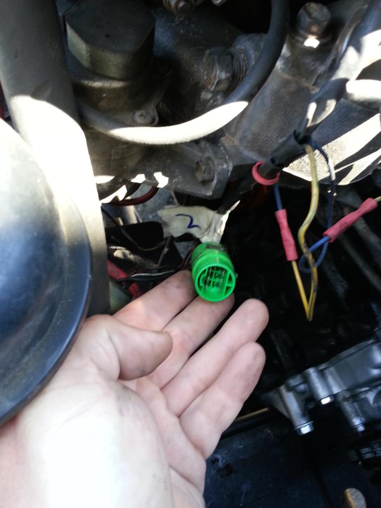

The second issue is this guy>

I am not sure what it is called or what it would connect to past the harness.

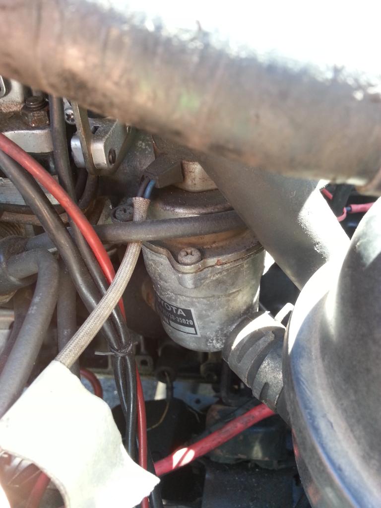

The first plug is connected to this>

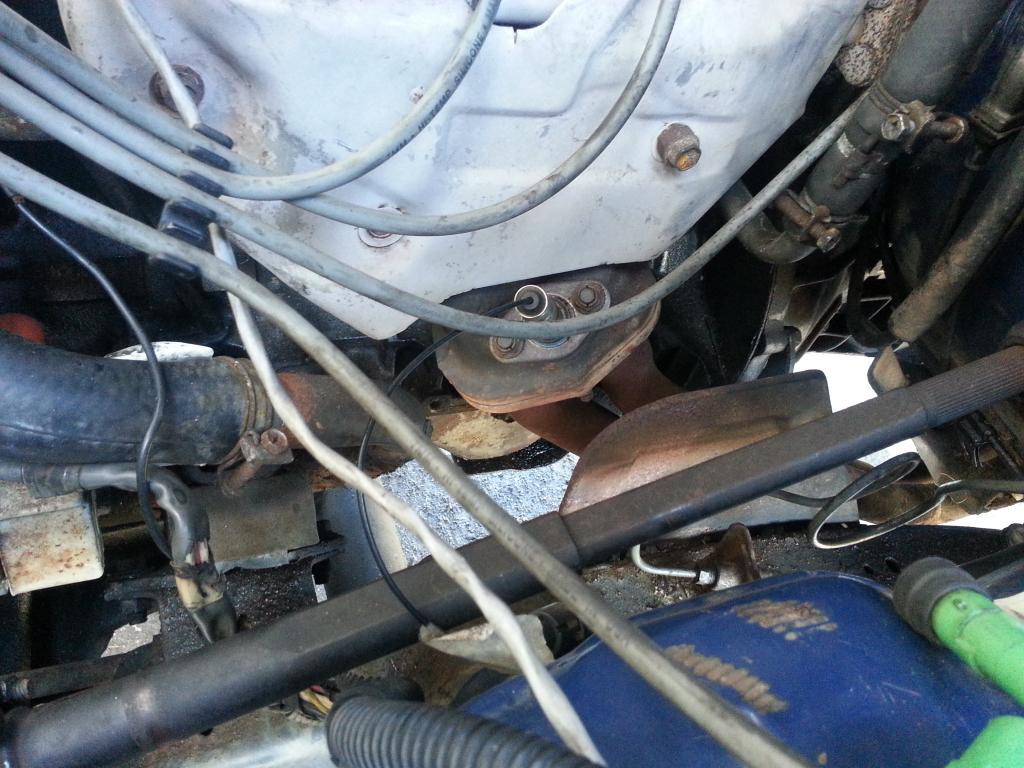

The second is connected below the exhaust manifold to the pipes going to the cat.

The one with the second issue that you were talking about in the post above.
I don't know the carb as well and I am not recognizing the that part that ends in 35020. May be when I see his truck I will recognize it. This is on the newest picture that you posted.

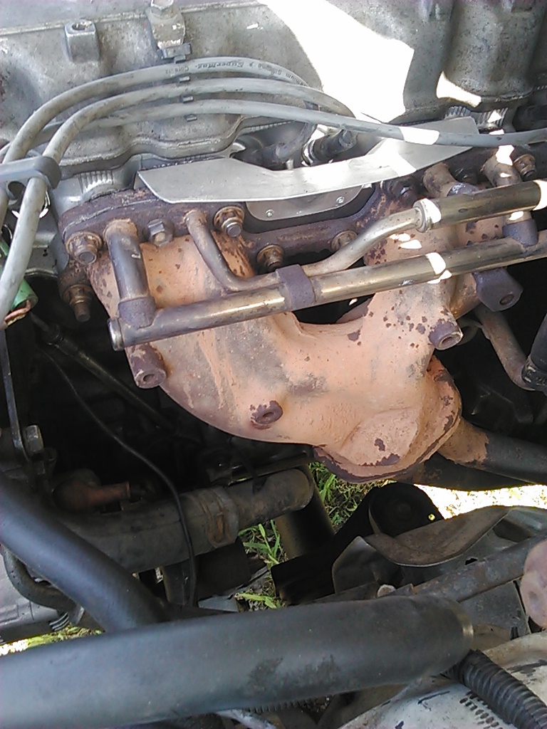

Ok, so got the pictures of the connections I am missing on the new harness.
The second connection that I was asking about that is on the drivers side connected to the exhaust. It is the plug marked X.

Here the the palce on the exhaust it connects to in the light of day>

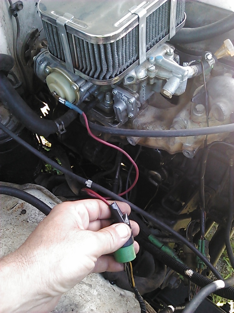

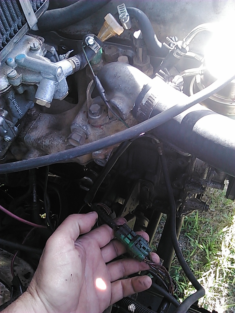

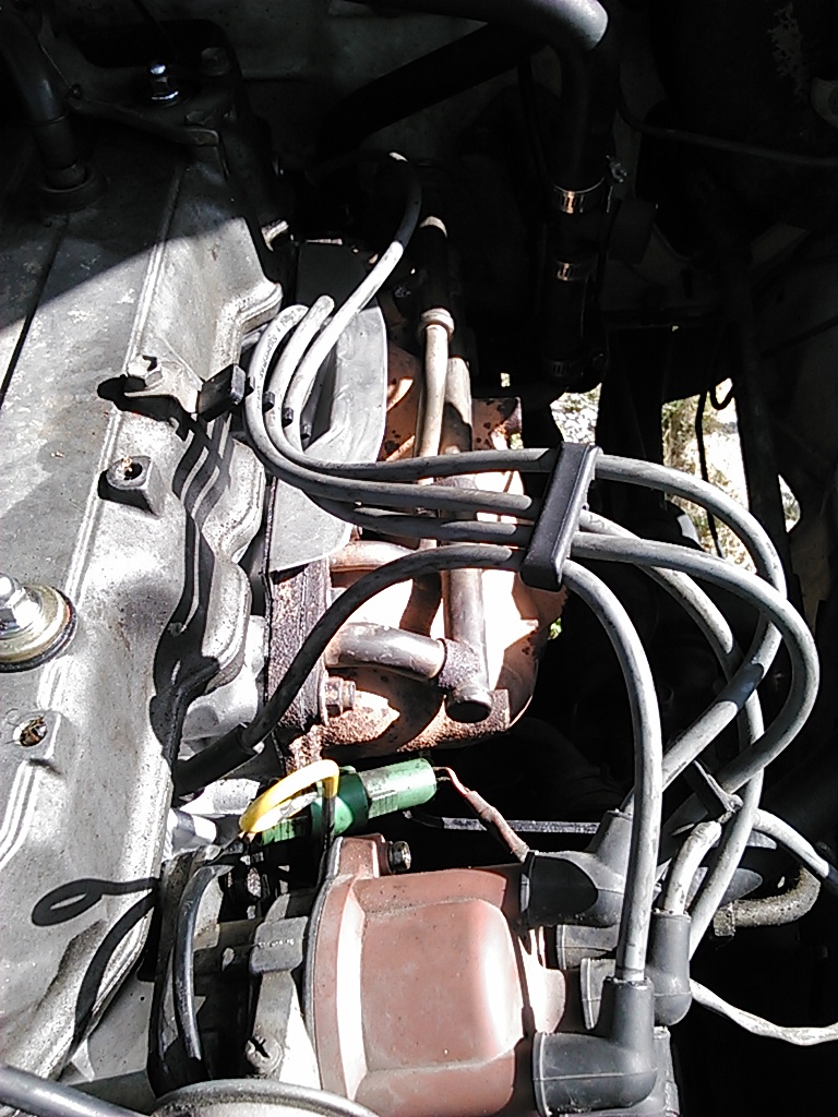

My brothers truck isnt showing anything like you have, His is non California and has a Webber. Probably what you have is emissions.
Here is some pictures of his.
Only green plug goes to distributor.
Off of main harness and goes to carb. Not sure what it does.
Goes to Temp senders off of same harness.
