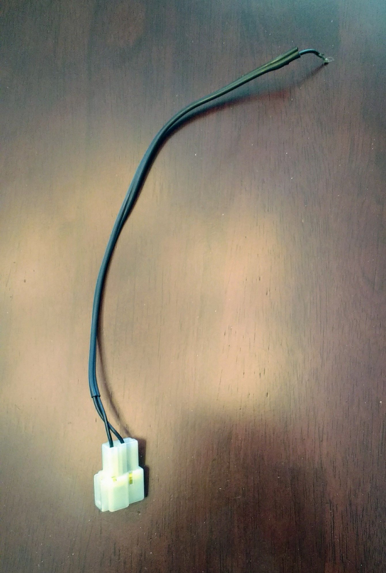

Found this wire behind the bench seat. The connector was plugged into another connector coming out from under the carpet, near the seat belt.
Is it for a seat belt warning/reminder? Where does the stripped wire end attach to?

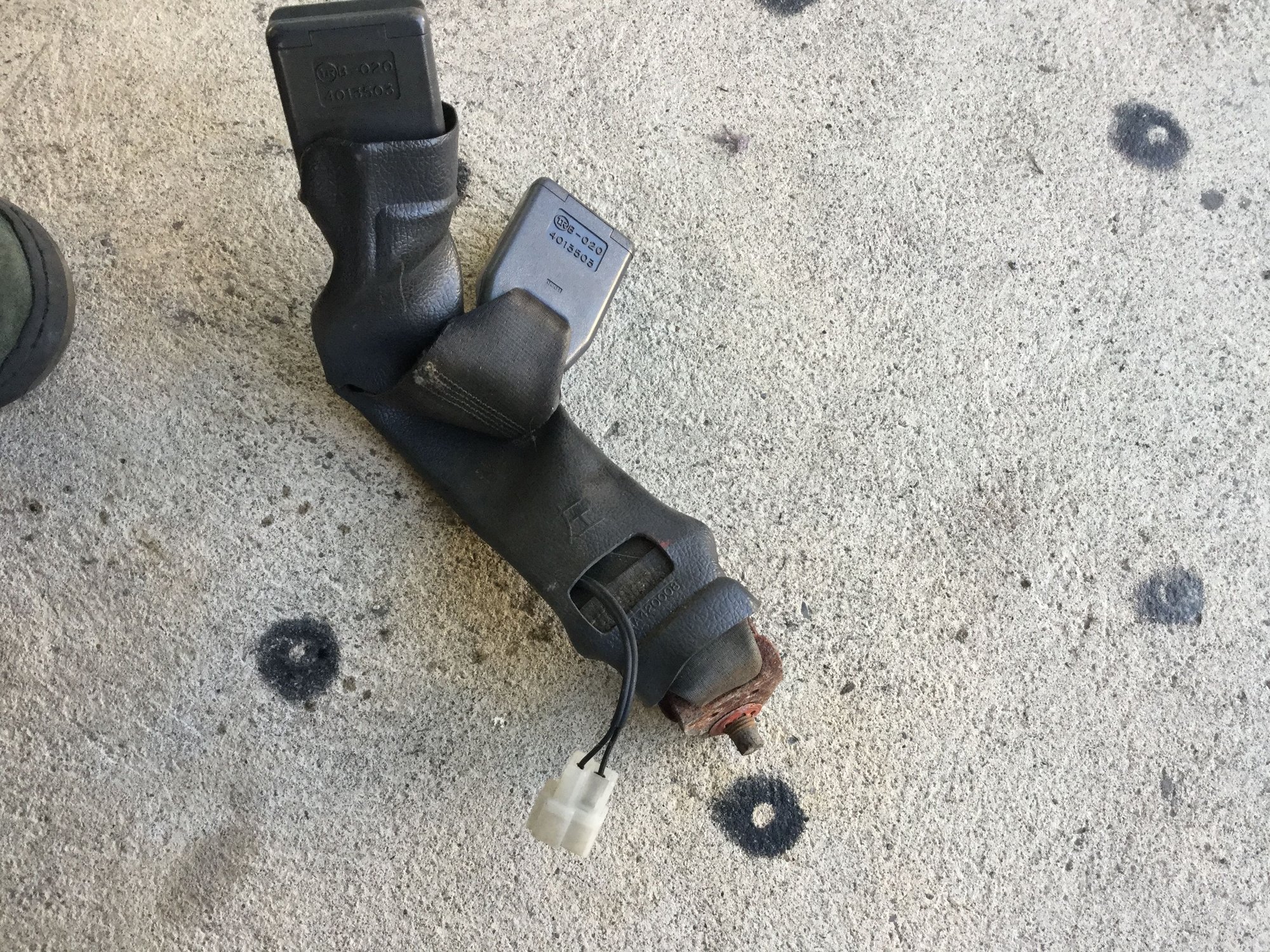

Has to be the seatbelt buckle switch that P.O. ripped off.

Wouldn't it be more accurate and quicker if you inspected your seatbelt buckle switch wiring?
Do you get a seatbelt warning when you unbuckle you seatbelt while engine is running?

I want to say seat belt idiot light, I think my 93 DLX has one down there too.

The wires for the seatbelt switch should be B and W-B. Your picture makes the wires both look G. Are they actually that color? The connector looks right.

Thanks for the responses and pics, yep.. that looks like it. I'll have to see if I can find the other end of the wire under there.
I looked for a bit, it must be under the carpet somewhere.

It should run behind the rail where the front seat mounts on to the door threshold, to the connector behind the left-side kick panel.

Your image shows a female socket, user provided image of latch shows female socket, you say in the first post it was plugged in... Your loose wires go inside the buckle/latch, probably not easily repaired...

Originally Posted by Co_94_PU
...... Your loose wires go inside the buckle/latch, probably not easily repaired...
This^^^ Once confirmed it is for the seatbelt, which I really think it is, I'd just leave it alone, unless O.P. needs a reminder to put seatbelt on.
Which would also explain the (lack of) color.
