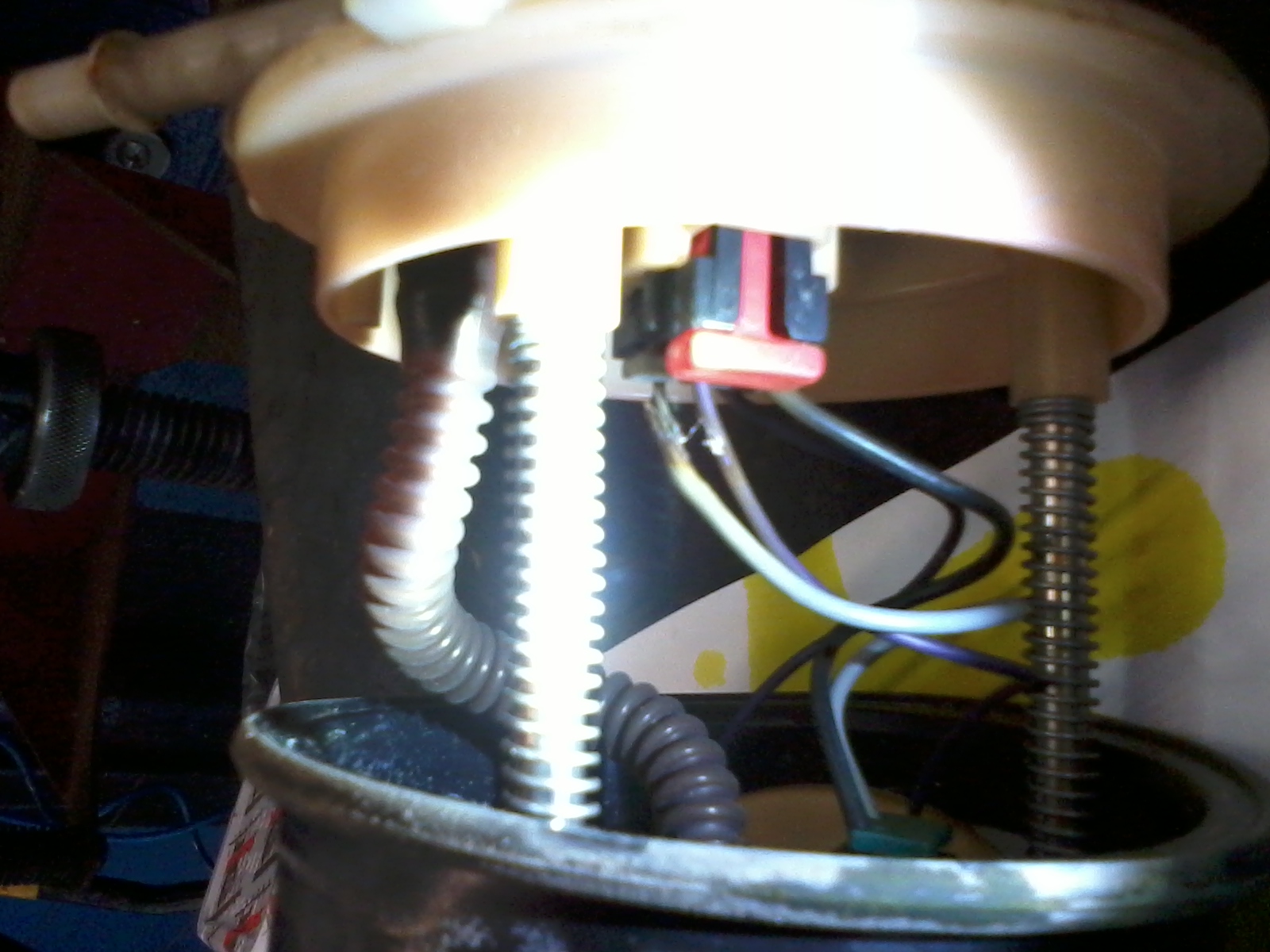

Now GM's have a different problem. The wiring connector that goes to the pump was not designed to handle the current that is drawn by the pump. So over time the pump overheats the connectors causing them to arch and burns the wiring and the pump up.
Here is a picture that will make you think!
This vehicle would shut off when making a hard left turn below half a tank. The wiring overheated and the positive and ground were shorting together inside the tank!

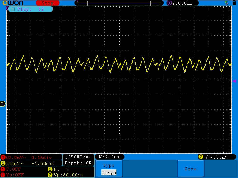

Here is a waveform of a worn out fuel pump. You are looking at the current draw of the pump on an Oscilloscope. Each little hump is a commutator in the pump as it begins to hit the brushes.
The erratic spikes show how the commutators are worn out.

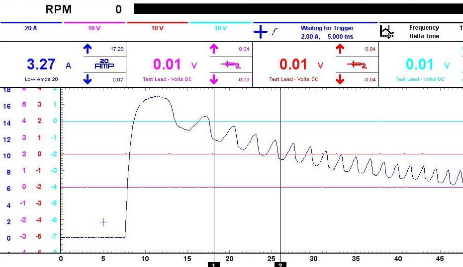

Here is a good one.
