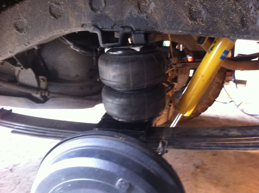

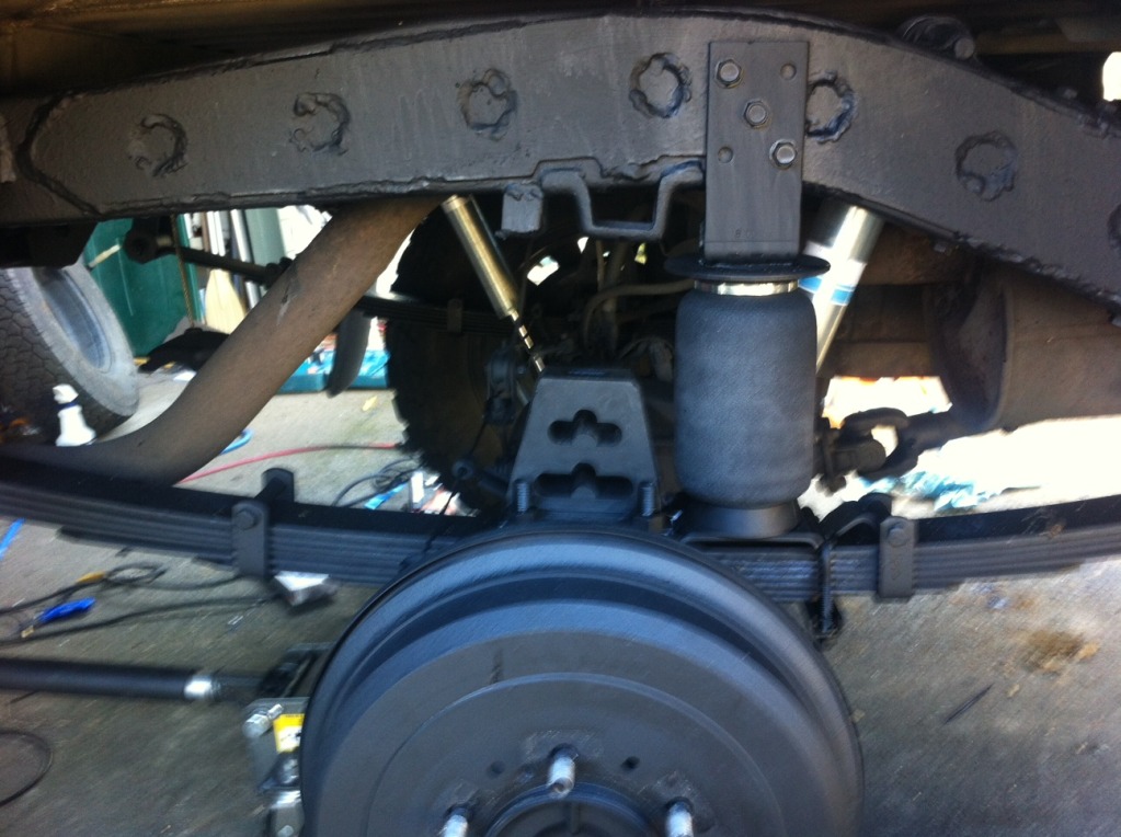

Old Nov 21, 2013 | 06:28 PM
ThatGuy1295's Avatar
Joined: Jan 2011
Posts: 1,746
Likes: 6
From: 46 50' 36.82'' N 122 19' 41.01'' W
This was the F-150 setup. It could haul 4 suns and a moon lol..
This is the deavers with 5100's (D559/D560.) shocks, and air bags that I run at about 2psi when empty. It rides amazing with around 2 to 300lbs in the bed but otherwise its an extremely firm suspension. But even though it doesn't say that on their website Im thinking the shocks are valved for over landing or something were you always have gear in the back. The D559/D560 shocks are valved specifically for the deaver springs.

Old Nov 21, 2013 | 06:34 PM
HighLux's Avatar
Joined: May 2010
Posts: 2,587
From: Ofallon Missouri
I was just gonna say...most pickups ride rough with no load.
My e350 econoline superduty extended is stiff with no load.....put a couple tons of tile in there....rides like a caddilac.
