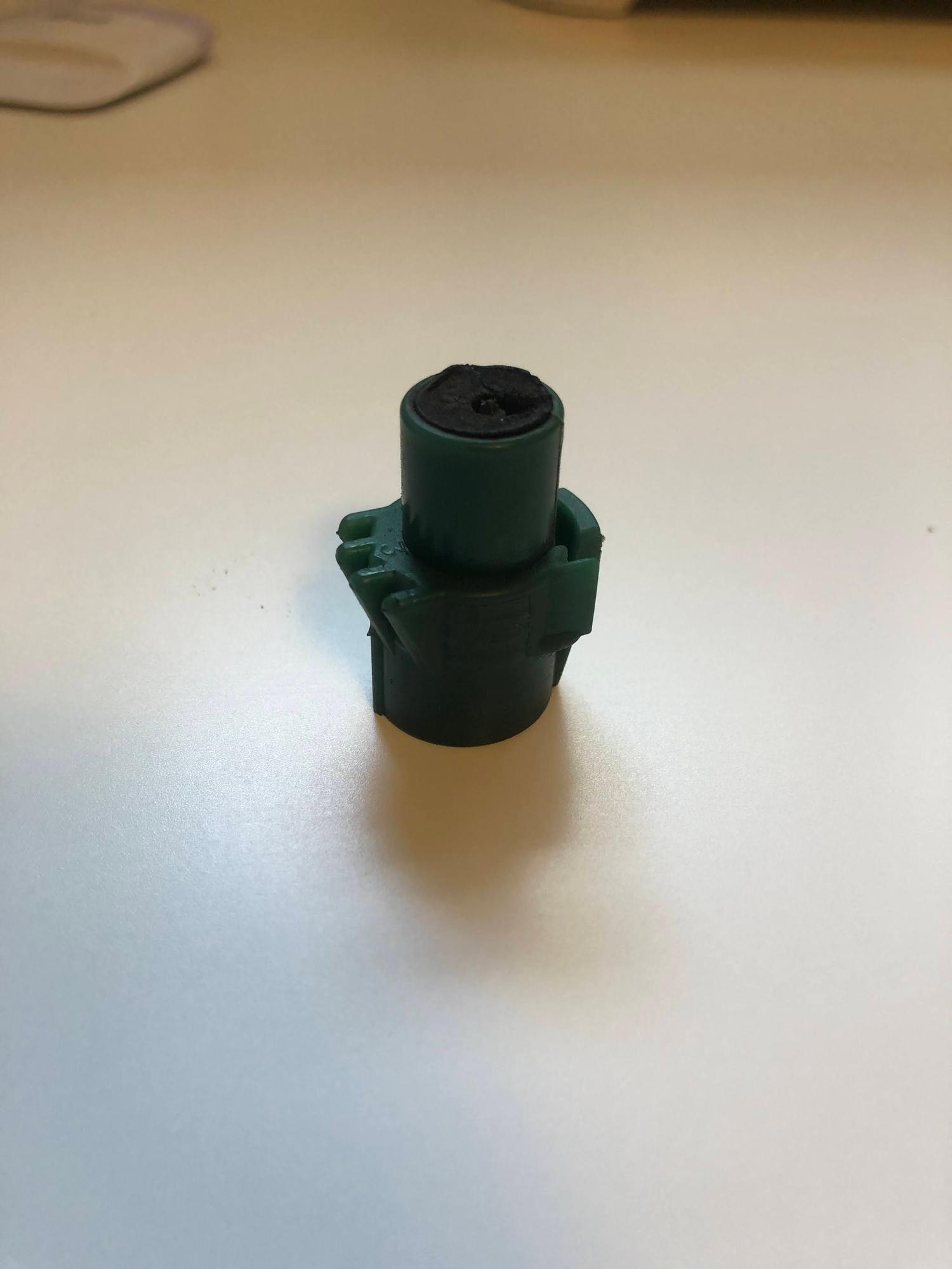

Hegy guys this connector / wire was broken off in my 1987 22R Pickup engine bay. The connector is close to the thermostat housing. It had a green wire with red stripe. Any ideas on what this is for ?

Looks like possibly 22R coolant temperature switch connector. Does it look like it would plug into this?

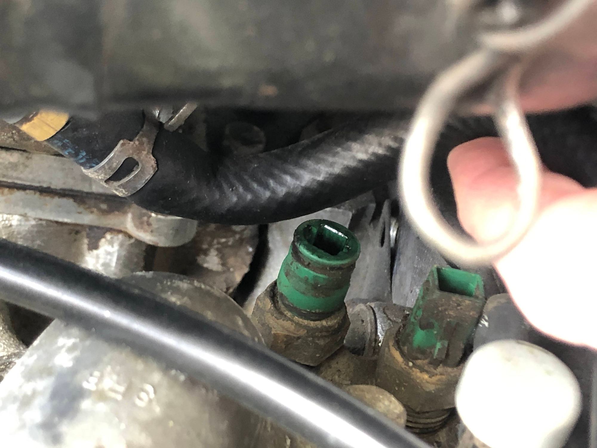

That is probably it, here is a pic of the sensor on the engine

Yep, that looks like it on the left.
