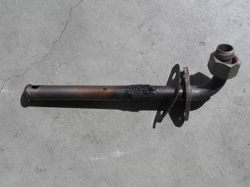

Originally Posted by J94
... I'm just concerned the EGR system causes carbon buildup and sludge? .../
No, leave the EGR alone. That carbon buildup is caused by the PCV system. I haven't worked on a 22re, but the 3VZE also has a problem with sludge buildup in the plenum after, oh, 20 years or 200,000 miles. After carefully cleaning mine through a head gasket replacement, here's a picture of the EGR inlet tube about 15,000 miles later. The end of the tube where the EGR gases exit is spotless, but the ring of sludge is right next to the PCV inlet.
Deleting the EGR won't do anything to improve performance, and the higher combustion temperatures will probably shorten the life of the piston and head. More importantly, as old87yota points out, it's the air you (and the rest of us)are breathing that you're poisoning.
