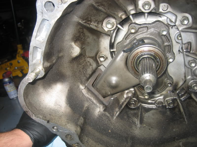

That is the other bearing that you can use. I have bought one of those straight from the parts store and it is not much. Finding the black clips for it can be difficult. I find those laying around in the boneyard I get them. I have used both styles of bearing. The other style, has an orange seal just seems to be a better bearing. Currently I have one of each in both of my trucks.

Ahh crap i put the new bearing in and put the motor in and its bolted in place. Now im just rethinking installing the bearing and i know its clipped in place but im not sure which way i turned the bearing when i installed the clip.
They sent a KOYO bearing so im not sure of how the clip goes in place either

Well i know the lip is out toward the pressure plate and pulling the boot back looking through the hole i can see the clip is in place on the back side. I worked the bearing on the arm out 4 or 5 times before i started the engine install. Im just not sure if the bearing has a rotational line up. Im sure its right but i didnt verify myself before the engine was installed....
