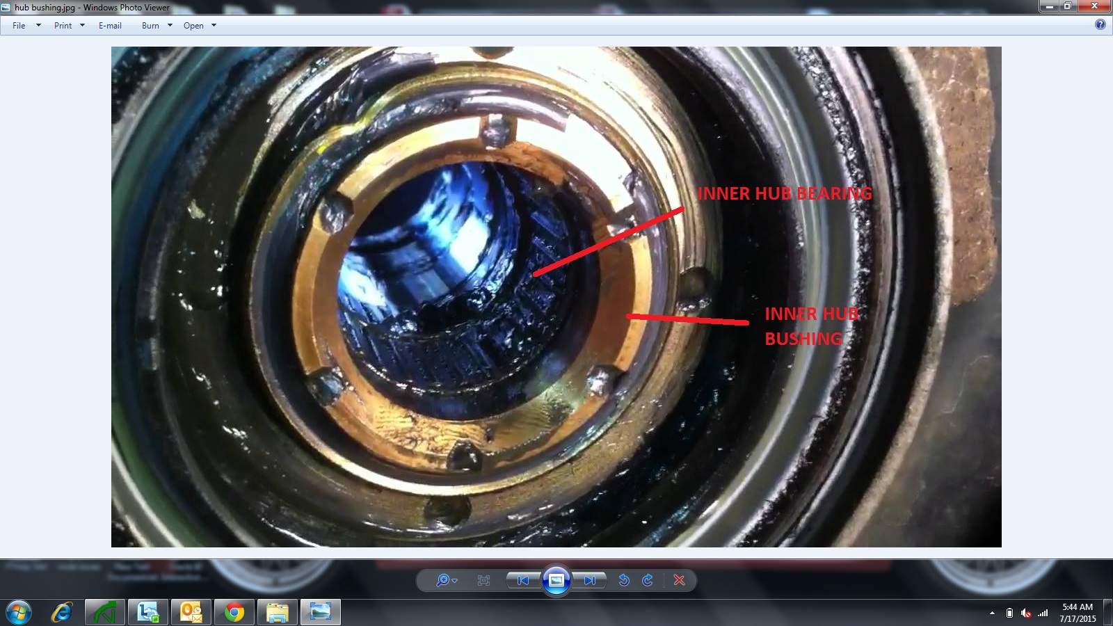

Hey,
I could really use some help. My inner hub bearing is shot. I pulled the steering knuckle and found the inner brass bushing. From what I have heard these are pressed in. My question is; how do you press out the bushing? And when said bushing is pressed out, will the inner bearing come out with it? The wheel bearing it self is fine.
Thanks
-Greg

95.5 Tacoma
Single cab
5vzfe (not sure if the engine matters)
Manual locking Aisin hubs
This is located in the back side of the steering knuckle.

I know the 2nd gen tacos are configured this way. ORS sells the brass wheel bushing and the inner hub bearing. So I figured it has to be serviceable

You have to pull the brass bushing in order to get the roller bearing out. Pull brass bushing with a "Blind Hole Bearing Puller" . This tool is available at Harbor Freight Tools for around $40. Works like a charm! Good Luck!
