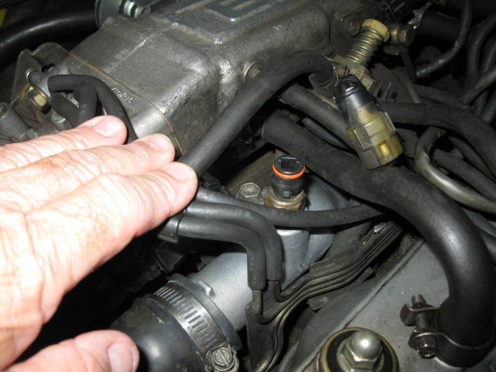

Hello all. First time poster, long time creeper. I have an 87 22re 4runner. I've only driven it 100 miles since it broke down on me and left me in shame of my bad purchase, so this will be my first post of many I'm certain. But first issue I want to address, is how to address OBD Code 4. The temp sensor aft of the coolant hose to the intake has a shotty cable, and since removing it I can see it's in bad shape, so I know this needs to be addressed whether it solves the CEL. I assume it's the temp sensor for the gauge, but I've read people say it's for the AC cutoff. The one I have does not look like photos, perhaps it's even the wrong sensor. I know embarrassingly little about this trucks history. But can anybody confirm what sensor this is, whether cooling sensor, gauge sensor, or even possibly AC cutoff? And have they ever seen one look like this?

This is not the AC cutoff, you can tell by the round housing and because the wire is coming out if the engine harness.
The AC cut off comes out of the body harness and has an exposed spade connector.
The temp guage sensor is actually located farther back on the intake. Shine a flashlight down beside the cold start injector and you'll see it near the head side.
The sensors for the ECU are located below the radiator inlet hose and face the front of the vehicle.

Appreciate the reply, that helps to understand what it isn't. From the circle on the engine photo, can you tell me what it is?

Maybe this will help
89428-28030
Switch, Temperature Detect
https://www.megazip.net/zapchasti-dl...ystem-17850685
Jim

Uhm, isn't that indeed the temp control for the ac?

Thanks Jim! Now that I see it with the part number in a diagram, which by the way is a great reference, I can find it online. Which btw, appears to be called a Coolant Temp Sensor when I search for that part number. It's only ~$17 on Amazon, supposedly being a Toyota part. Wonder why such the price difference?
AC cut off on the left, has an exposed male terminal, it's wire comes from the harness on the fender.
TSW on the right, has a round plastic housing around its terminal, it's wire is part of the engine harness. (This is the one pictured above)

Part: 89428-28030: SWITCH, WATER TEMPERATURE on Thermostat Housing
Mine is for a 1986 SR5 4wd EFI, so remember they will be different
Those ones on Amazon may not have right connector
I had to go to Toyota
Jim

Originally Posted by coastal
coolant thermo switch (ecu-tsw)
Needs ground through bare, shiny metal of mounting threads. I refurbished mine: https://www.yotatech.com/forums/f199...l#post52391719
