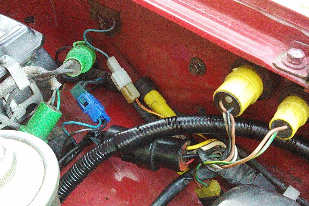

IF 22RE, VAFM or connection to it malfunctioning? To verify, jump the pins of the fuel pump connector (rectangular one hiding in lower right-hand corner here: Name:  KIMG0133_zps7c73eb1b.jpg
If that fixes the problem, look at VAFM, Circuit-Opening Relay and wiring between then two.
