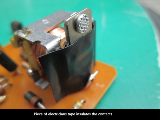

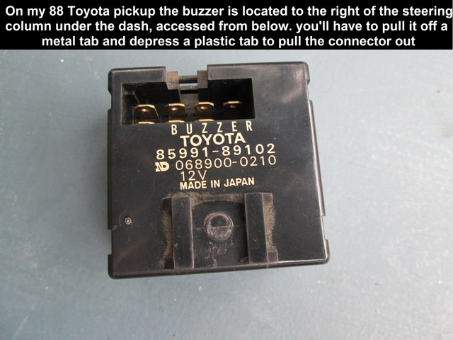

Silence is golden. disabling the buzzer.
You could just unplug the buzzer and throw it in your toolbox but depending on the year/model
you might lose features you'd like to retain, such as door controlled cab lighting, headlights on
reminder or the ignition key light. here is an easy way of silencing the buzzer while retaining
all the original features

Great illustrations here, I've always wanted to do exactly this!
(But then I'm afraid the following day will be the one time i lock the keys inside.)

My 87 doesn't make a noise if I leave the keys in. I wonder if that box has been removed or is broken.
I do have a 87 base model long bed and I do mean base model!
Old Aug 29, 2016 | 10:22 PM
Terrys87's Avatar
Posts: 11,787
Likes: 28
From: Anderson Missouri
Your base model did have the buzzer for the key. If your dome light is not working when opening the drivers door but works on the passenger side, the box is either disconnected or missing. It is located on the steering column.

Does anyone know if that buzzer sounds in the event of a loss of oil pressure or any other potentially catastrophic event? I hate the sound of the thing but I'm not touching it if it might alert me to a big-time problem even half a second sooner. I assumed it had some kind of function other than to remind you that your keys were in it due to the way it gives a test buzz before you crank it up. I'll kill mine the next time I'm in the column if it doesn't. There's 7 pins on that sucker. I'd like to see a pin-out on it.
