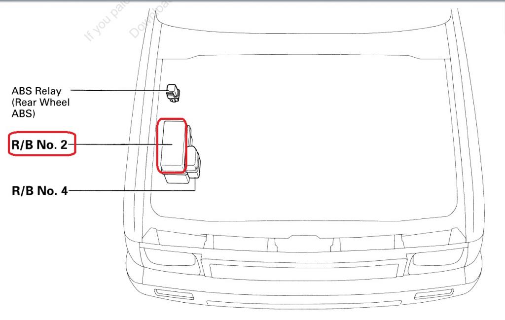

COOL, but need to include "A/T" in signature. It matters significantly when troubleshooting. It takes too much time to read the whole posts, many of them wordy, to find just those three characters "A, / , T".
Do not mess with the alternator, YET. It will not cause a click-only issue directly.
Yes, go ahead have your battery tested.
Shifting through gears will not absolutely eliminate doubt on neutral safety switch (NSS). If it is defective, putting it in neutral or park will STILL not do anything.
You still have not told us exactly what clicks. Starter relay? Starter solenoid ? Again, that will tell us a lot, and save on numerous posts back and forth. Let me reiterate, a problem well-stated is a problem half solved.
I believe your generation truck has starter relay in relay block # 2
Red line shows power path on 1990-1995 V6 A/T.
After you are absolutely sure that battery is good and reconnected properly, I strongly recommend you do this, even if you do not have a cranking issue anymore. Toyota had messed this up on first-gens. There is no guarantee it did not do it on second-gen 4runners:
Check voltage on pin 5 of starter relay. There should always be 12V there, even if ignition switch is in OFF position.
If still having issue, try this special service tool to bypass starter relay and NSS.
