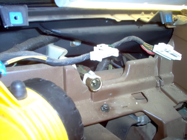

well i yanked it all apart just now, and found what i would think to be the culprit.
the weak@$$ heat guard around it, is dried up, and with the speedo cable wedged right against the exhaust manifold, i guess it got melted, and dried up.
the tcase side spins freely, the dash input side, wont spin even with a pair of needle nose pliers trying to get it to move. as i was taking the cable out from underneath i could hear it cracking, and noticed the part right by the manifold.
