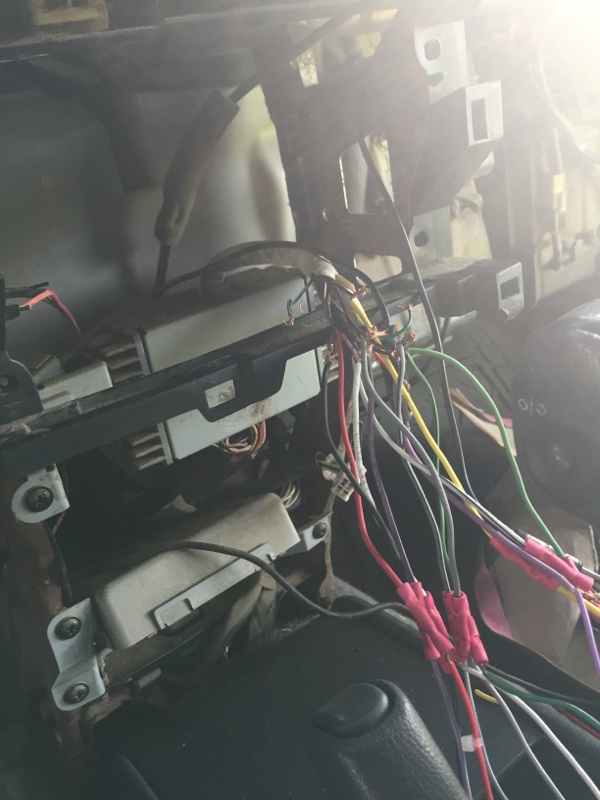

So I attempted to install a new radio in my 95 4Runner and I did everything the wiring diagram on 12volt.com said and it's still not working. Looked up so threads and saw that people had a problem with blown fuses, we'll all mine are good so I'm at a brick wall. If anyone knows what could possibly be going on that would be awesome thanks guys!
Attachment 102799
You didn't splice into the factory wiring did you? Every install I have ever seen uses a vehicle-specific wiring harness with the factory radio connection on one side, and bare wires on the other, that you solder to the harness that came with the radio. This makes a little 1-foot adapter cable that makes the new radio plug right into the factory plug.

I did splice into them but the diagram on the website I used tells you which one to connect.

You butchered the factory harness and created potential electrical problems rather than purchase a $8-$20 harness that will plug right in?
I've even seen plug in stereo harnesses in Walyworld for these trucks.
This isn't a personal attack so don't take this the wrong way but it's no wonder you're having problems.
There are some areas where it makes more sense for a do it yourselfer to leave alone, and this is one of them. Many Toyota owners experience strange electrical problems when they hack into the original harness, including me. (I purchased it this way)
This is the type of ill-contrived modification that gives experienced car people the heebie jeebies shaking their heads and talking under their breath when they see it. Not to mention lowering the value of the vehicle in their eyes.
I'd reconnect the original plug and get a plug in harness.

it's already chopped, and i've dealt with these situations, even did a few many, many years ago myself..... anyways, you got to get those wires away from each-other first thing, then test for battery power (might be labeled "clock" or something) then ignition wire, then, and this is where most make the biggest mistake: verify the illumination wire. it will read ground and then switch to power when you turn the lights on. it will chassis ground through the antennae shield, possibly blowing a pico fuse in the radio (horrible rca noise) and the radio won't operate right, along with the dash lights. iirc, you need to turn the factory amp on via the blue wire as well. it's been a while since i did the 4runner, so can't remember. was the site "the12volt.com"? i don't recall them having vehicle specific wiring diagrams...

Try to find the factory wiring diagrams to make sure you hooked up the wires correctly. Also make sure that every connection is clean and tight. I have seen the butt connectors cause problems with loose connections.
Also make sure no wires are trying to ground out causing a short circuit.
You might need to use a multi meter if you still cannot get the radio to work.

there is absolutely no power from the wires at all and all my fuses are good.
Then break out the schematic, trace all the wires where power is supposed to be but is not back to Ignition switch accessories contact, to fuses and battery.

Uh, what does that mean? I'm going to guess that you put your multimeter from frame-ground to each wire individually, and with key-on you didn't get VOLTAGE at any wire (not the same as "power").
First, there's a lot of metal around the radio that is NOT connected to ground. Find a wire somewhere (fuse panel?) to verify you're measuring from ground.
Which wires did you check? There shouldn't be any voltage on the speaker wires, of course. I assume you were able to find all the correct wire colors. If that's the case, the one you care about is the L-Y (Blue-Yellow) from the dome fuse, and the GR (Grey) from the Radio fuse (that fuse is connected to ACC on the ignition switch). The L-Y wire just keeps the memory alive, so it won't contribute to the radio "working." It's the GR you care about. If you still can't find 12v, then you've got a wire disconnected in the 18" from your radio to the fuse panel. It's that simple.
(Of course, once you get your testing procedure down, if you DO have 12v on GR be sure to check that BR is really connected to ground.)
