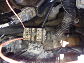

pressure should be about 40 psi. attach pressure gauge. Turn key to ON, jumper the wires, and look at static pressure and then running pressure.
Edit: I re-read your post, seems you already know how to jumper the diagnostic block. I think your code 14 could be the culprit. here is a thread with guys having the same issue.
https://www.yotatech.com/forums/f116...e-14-a-130369/

You can also jumper terminals fp and +b in the diagnostic connector this will make the fuel pump run constantly. If the truck runs like this you have an electrical issue and the pump is not being powered for some reason.
