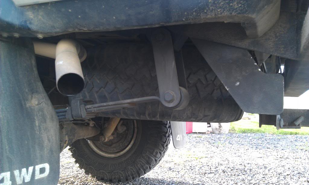

Old Apr 29, 2013 | 09:06 PM
jjmoss99's Avatar
Joined: Jan 2012
Posts: 46
From: Eastern Washington State
Thanks for the replies. Below is a pic of the snapped spring. It is the lower spring that has the rubber dampener attached to it.
Currently i'm unable to find a used spring so I belive i'm going to have to save up the money to buy new springs.
The other problem is that my tires are shot. Does anyone think that if I get new tires this broken spring will cause wear on my new tires or should I replace the springs first. I have the money saved up for tires and if I need to buy springs first i'll have to park the truck for a while and drive something else. Thanks again for everyones help.
Justin

Well it is possible that the broken Spring may move digging into the sidewall of your new tire.
Been there bought the springs and new tire

Why does it look like theres another leaf there that shouldnt be? Unless its an add a leaf?
Either way its that leaf looking thing just above your overload leaf is what broke your number 3 spring.
Should be 3 + 1 leaves not 4 + 1.
1 is the overload leaf.
Old Apr 30, 2013 | 07:20 PM
jjmoss99's Avatar
Joined: Jan 2012
Posts: 46
Yes when i lifted it 14 years ago they used a lift block and an add a leaf for the rear. I wasn't sure which of the bottom springs was the stock spring and which was the add a leaf. It seems that the add a leaf would be better placed on the bottom of the stack so that the stock toyota springs are all together.
I believe I broke the spring about 2 years ago when I hit a deer going 65 mph. It hit my front passenger tire and then went under and was run over by the rear wheel.
Thanks.
Justin
