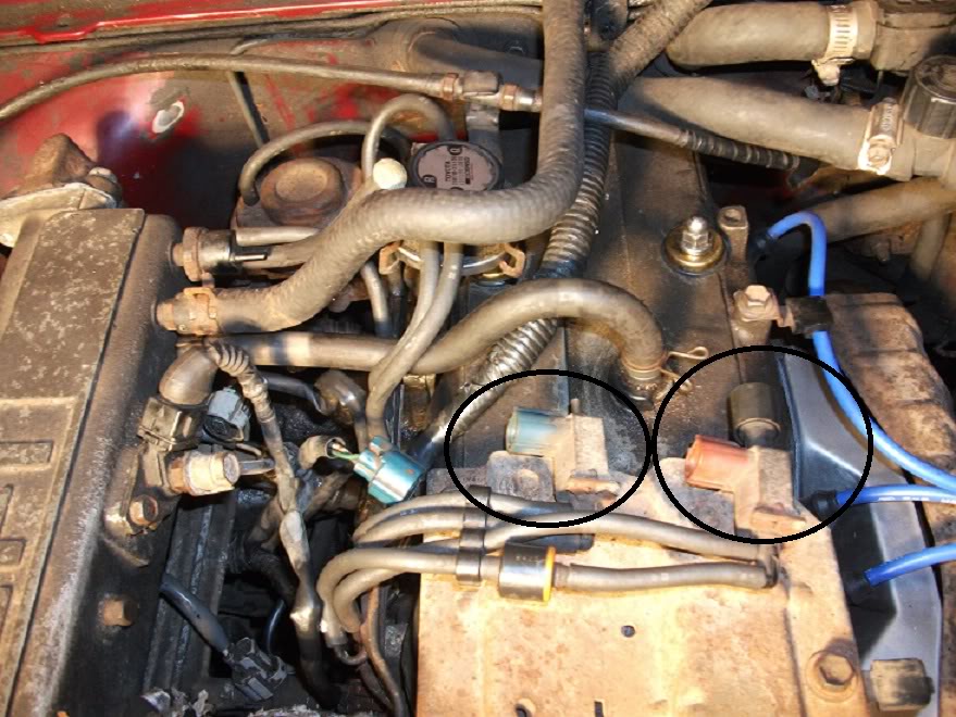

I also don't have these plugged in, was hoping it'd just be emissions that would suffer if they weren't plugged in, I almost had everything back together when I realized they wouldn't reach, because I put the wiring harness under the fuel rail stupidly..
It keeps puffing out pops of smoke, i can't tell from where, smells kinda weird. My next step will be taking apart the intake side again, and putting the harness over the rail, so they'll reach, and try again with them plugged in. For now, I need to catch up on some school..

Okay, so worked on the truck today, got them plugged in now, but still won't start. Its smoking when it turns over. Going to get some help now, my friends friend apparently is right into Toyota, hes got a 2wd at my school. I'm gonna ask him if he can get it going, if not I'll tow it to a garage. Their charges should be way less than the original head gasket price would be, so I'm not looking at it as a total fail.. yet. lol.
