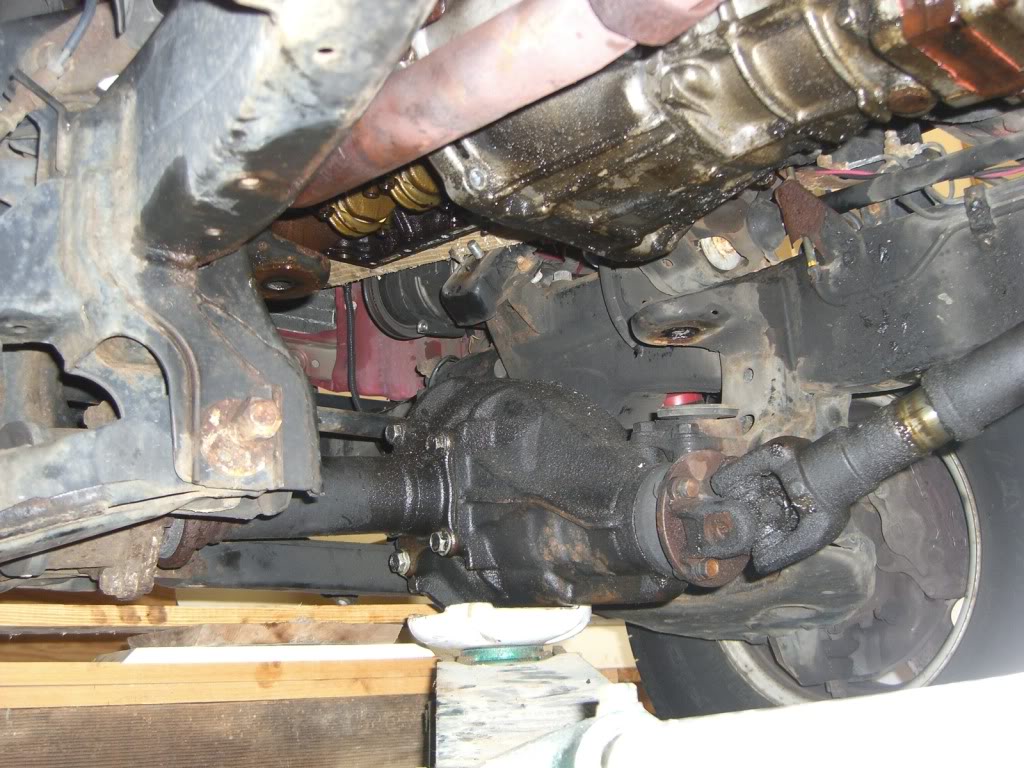

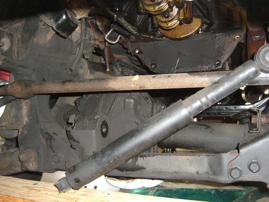

i removed 3 bolts, and did not remove the driveshaft. i removed less than you did

Oh irab88, I appreciate the correction, but I count 4 in your pic alone plus you raised the engine a few inches!
To be fair though, I forgot the crossmember is held on with two pairs of bolts instead of just two bolts, so add those to my number... your write-up was a huge help to me though, you even took the time out to e-mail me, thanks!
EDIT: I counted the bolt connecting the diff to the crossmember which looks like it was for something else, I'll accept your count of three PLUS the two engine mount bolts and the time to raise the engine up! So you removed fewer bolts, yes. I just didn't want to raise the engine so I used your method and changed a little at the end.
