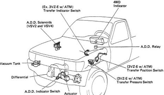

You can install manual hubs and keep the ADD. Then you can have both - lock the hubs before hand and drive with ADD unlocked, then put it in 4WD whenever you want. Great in winter.
There is a writeup somewhere about removing the ADD servo, but not the axle disconnect mechanism. Personally I don't see much value in doing that, the ADD mechanisms aren't prone to breakage.
But if you want to remove the ADD properly, you'll need to get a driver side axle tube and axle from a non-ADD rig. If you remove the solenoids you may have to do something with the wiring to get the 4wd light to work.
(edit) Looks like you just connect the two wires together at the axle and the light will work fine. Nothing else should need done with the wiring.

There is a writeup but you eith have to search for manual hub conversion. I can't remember the site. What i did when I converted to manual hubs was run the vacuum line that locks the ADD straight to the check valve that goes to the intake. Just bypass the vsv for the ADD and cap the "unlock" hose off. This is the quick way. Another way is to go into the ADD actuator and permanantly lock it.
One hose is red the other is blue (clean them to see the colors). After you do this yo can remove the canister on the passenger wheel well and the VSV for the ADD. Only do this for manual hubs. I did this because my VSV went out and I didn't want to replace them.
