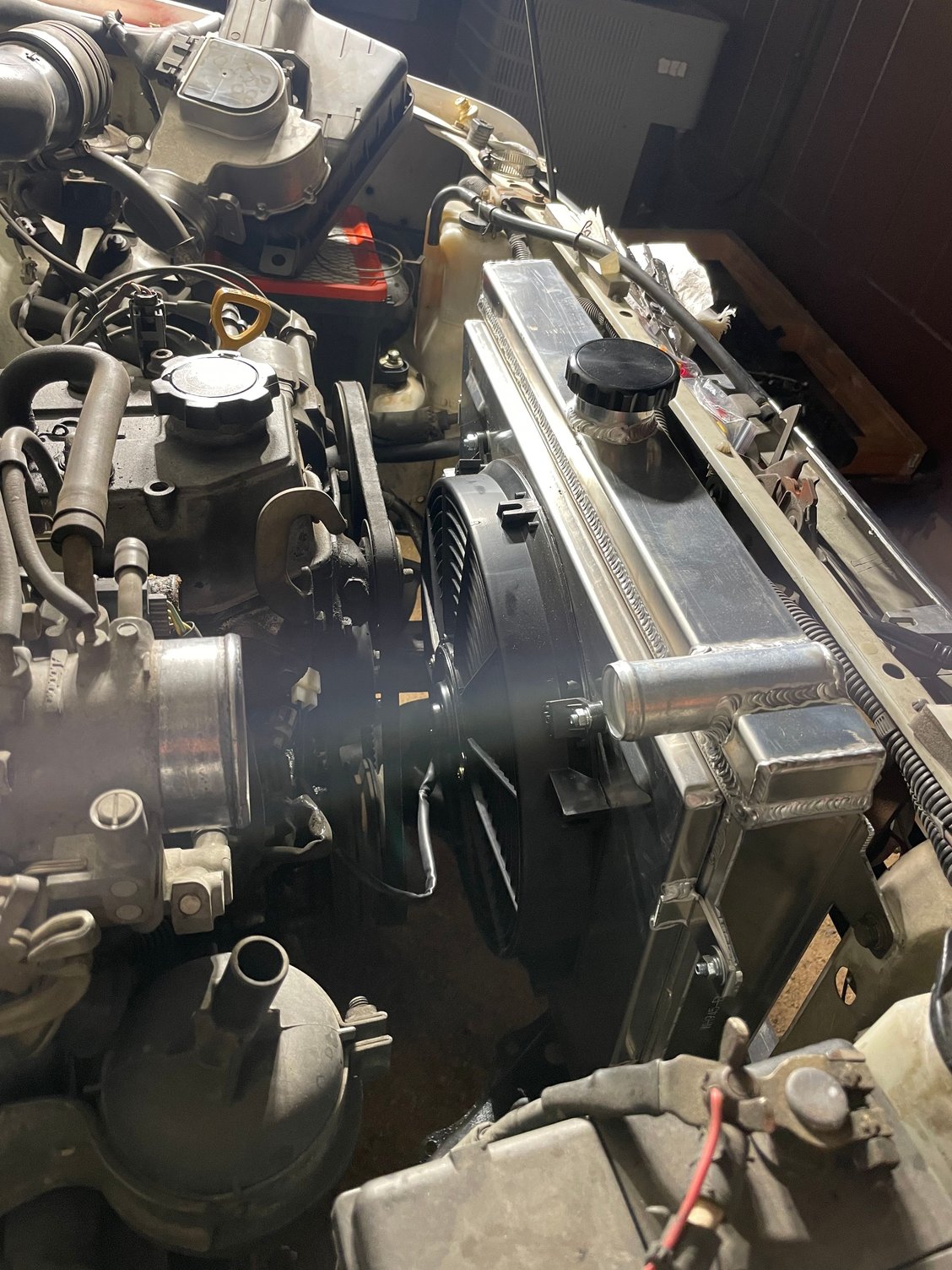

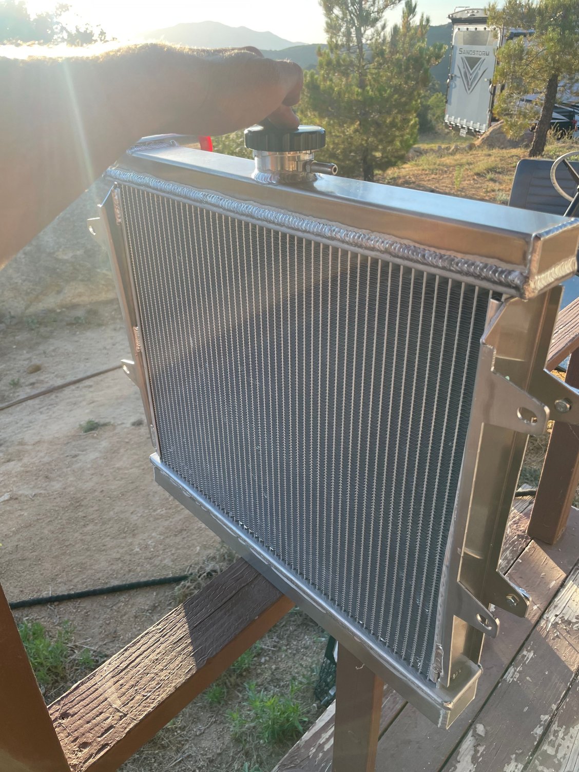

I have a 95 Pickup 22re.
Just installed this from alloyworks.
Seems to be pretty high quality.

That's some nice TIG welding!
