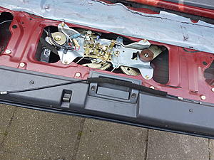

I had a similar problem, the passenger side of my T4R tailgate didn't lock correctly, I found out the latch cable was stuck. After several aplications of silicone in spray, problem solved.
