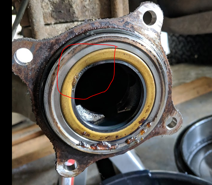

So, I pulled the axle off the leaking side and saw this. Pretty sure this is why the axle was leaking. The funny interesting thing though, is that it looks like the wheel bearing has already been replaced. It's the red KOYO that comes in the rebuild kits from Marlin Crawler. I wonder if they tried to fix this? Any idea what would cause the seal to get all deformed like that?
Old Apr 4, 2019 | 04:26 PM
millball's Avatar
Joined: Aug 2013
Posts: 4,261
Likes: 682
From: Southern Arizona
Somebody hit it in a way they shouldn't on installation.

Aaaand I ordered a bearing kit.
That's what I thought. Just wasn't sure if there was anything else that could cause that.

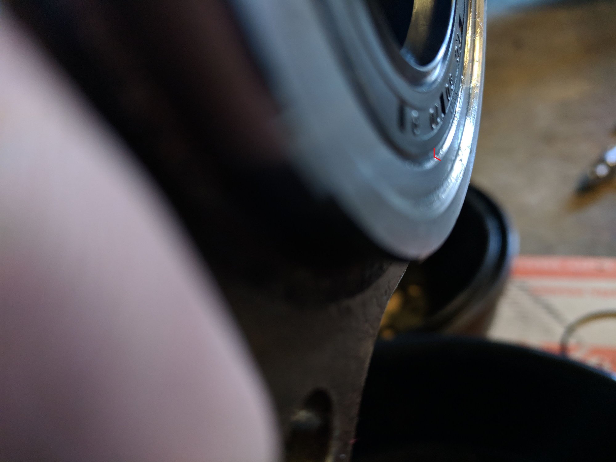

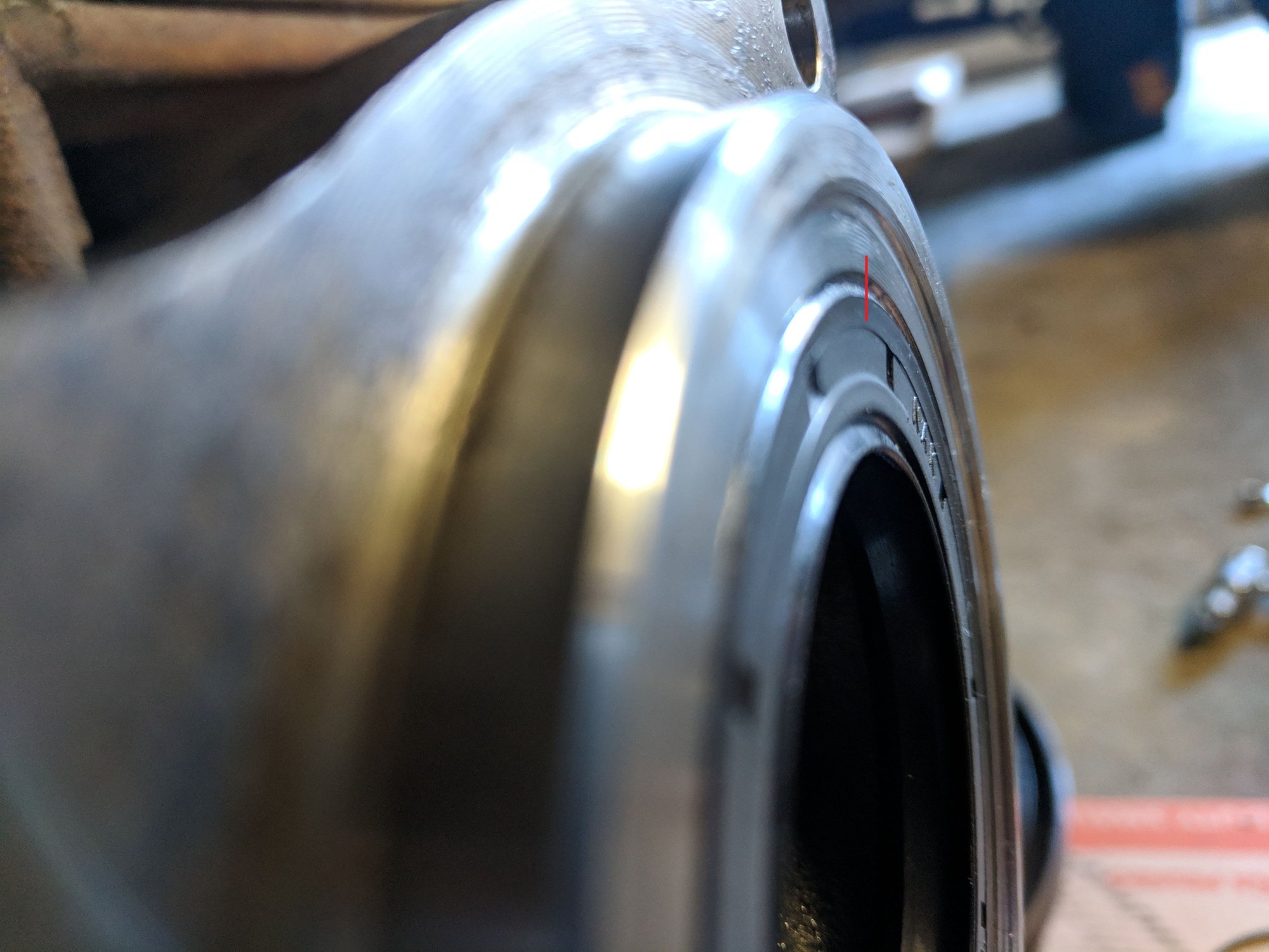

Old Apr 5, 2019 | 05:31 PM
881stgen's Avatar
Joined: Feb 2010
Posts: 191
Likes: 27
Ok, so now I am going crazy. I borrowed a bearing and race driver kit from autozone and tapped this thing in but I can't get it to sit evenly. If you look at the first picture, you can see the seal is ever-so-slightly recessed, while in the second picture the top right side of the seal is perfectly flush with the housing. Is this normal? Or is it supposed to sit recessed like the left side? I bought two of these so if I have to pull it out I can, but it will ruin it. It might already be ruined?
Old Apr 10, 2019 | 01:59 PM
881stgen's Avatar
Joined: Feb 2010
Posts: 191
Likes: 27
So I pulled the new seal out, set it aside, greased the second new seal I had bought for the driver's side (I never greased that the first one I put in) and as carefully as possible, drove it in. Well it looked the exact same. WTF. Upon closer inspection however, it appears that it was an optical illusion. It seems that it is in fact even all the way around. I put it all back together and limped down the road to a shop to have them do the rear drums for me. Two hours and $220 later I was up and running again and happy to report no more leaking gear oil! Could I have done the brakes myself? Yes. But with my limited time it would probably have taken me two weeks.
Old Apr 10, 2019 | 11:49 PM
ev13wt's Avatar
5 Year Member
Joined: Oct 2018
Posts: 611
Likes: 118
It's just fine - more than fine - perfect even.
This is not tech that needs crazy tolerances.
Sometimes the seal will form a groove in the shaft it runs on. Some Toyota replacement seals (the engine main front and rear come to mind) are in fact offset so they run on clean metal.
Grease that lip and stick it in there!
